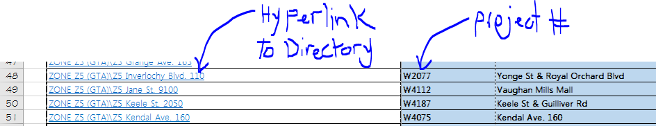

Sambuddy Posted October 7, 2019 Posted October 7, 2019 Good afternoon, My question has two parts: 1) Is there a LISP that can open an excel file by entering a command? Example: upon entering "POP" excel file in a directory on the server say, "F:\SALLE A DESSIN\2- ZONE RÉPERTOIRE_pop.xlsx" would open. 2) This excel contains all of our project numbers. All projects are hyperlinked so by clicking on each project the project directory/ folder would open. Is it possible to enter a command then enter the project number in autocad to then the excel file is searched and project directory is opened without having to open the excel and use find command in excel to open the project directory (All done in cad)? I am not sure if it makes a difference that the excel file in question is password protected and you have to press on "Read Only" button before entering the file. Thank you, Sam Quote

Sambuddy Posted October 8, 2019 Author Posted October 8, 2019 All I could provide would be the snapshot not the actual excel file as a test file - it would not be useful as all hyperlinks are linked to the server and cannot function even you have the test file. Quote
rlx Posted October 8, 2019 Posted October 8, 2019 correct but one would be able to see the structure of the file and the data format. Quote
Sambuddy Posted October 8, 2019 Author Posted October 8, 2019 (edited) Please see attached excel file as an example of what the file looks like. You can see that the project numbers are scattered on different columns (C for one type and G for another) . Hopefully this would give you a better sense of what kind of excel I deal with. usually when I open the main excel file I have to go to find and type in the project number to then select and click on the project hyperlink to open the file directory. Thank you, Edited November 18, 2019 by Sambuddy Quote
rlx Posted October 8, 2019 Posted October 8, 2019 (edited) though its easy to read the (string) values from the excel file itself , I'm not entirely sure (yet) as how to correctly read the hyperlink value itself. Never used hyperlinks before in an excel sheet but when I look at your file (in excel) , select one and use edit hyperlink I see there are 2 values , the text you see (the label) and the hyperlink itself. The text value I retrieve in lisp is like "ZONE Z5 (GTA)\\Z5_University_Ave._165" while the text for the link itself (in excel) shows "ZONE%20Z5%20(GTA)\Z5_University_Ave._165". Not sure if this is important or not (link-wise). At first glance they are practically the same, in your case , but what if they are really different? Could post my scrappy code what I have so far but it wouldn't be very usefull so I think I first sleep a night on it because I make very long days and my sight is getting blurry Sambuddy.lsp Edited October 8, 2019 by rlx Quote

rlx Posted October 9, 2019 Posted October 9, 2019 (edited) ah, just found out by experimenting how to get the address from an excel range (setq ExcelHyperlinks (vl-catch-all-apply (function (lambda ()(vlax-get-property ExcelRange 'hyperlinks))))) (vlax-for url ExcelHyperlinks (setq ExcelAddress (vl-catch-all-apply (function (lambda ()(vlax-get-property url 'Address)))))) should be able to put this to good use (when I can find some spare time) Edited October 9, 2019 by rlx Quote
rlx Posted October 9, 2019 Posted October 9, 2019 (edited) see if this works for you declared hyperlinks in column "B" and label in column "C" in _Init subroutine and path hard coded in subroutine _SelectExcelWorkbookFilename as "F:\\SALLE A DESSIN\\2- ZONE RÉPERTOIRE_pop.xlsx" ps haven't accounted yet for projectname in different columns but have to get something finished before I can go home so no time... Sambuddy.lsp Edited October 9, 2019 by rlx Quote
Sambuddy Posted October 9, 2019 Author Posted October 9, 2019 Hey rlx, Thank you for your hardwork in solving my problem. Unfortunately I am faced with an error after executing your LISP: "No function Definition: VOID" is what I am getting and no action. Could you please take a look again when you have some time? and it is true that hyperlink resides on column B but Label, project numbers (that would be what I usually look for to find the project before clicking on the hyperlink for example in Excel) is scattered on all columns (C through P). would that constitute a big problem? Thanks, Sam Quote
rlx Posted October 9, 2019 Posted October 9, 2019 (defun void (x) (or (not x) (= "" x) (and (eq 'STR (type x)) (not (vl-remove 32 (vl-string->list x)))))) column C - P probably isn't a problem (but a challenge)... biggest problem right now is time... pfff but I'll see what I can do Quote
