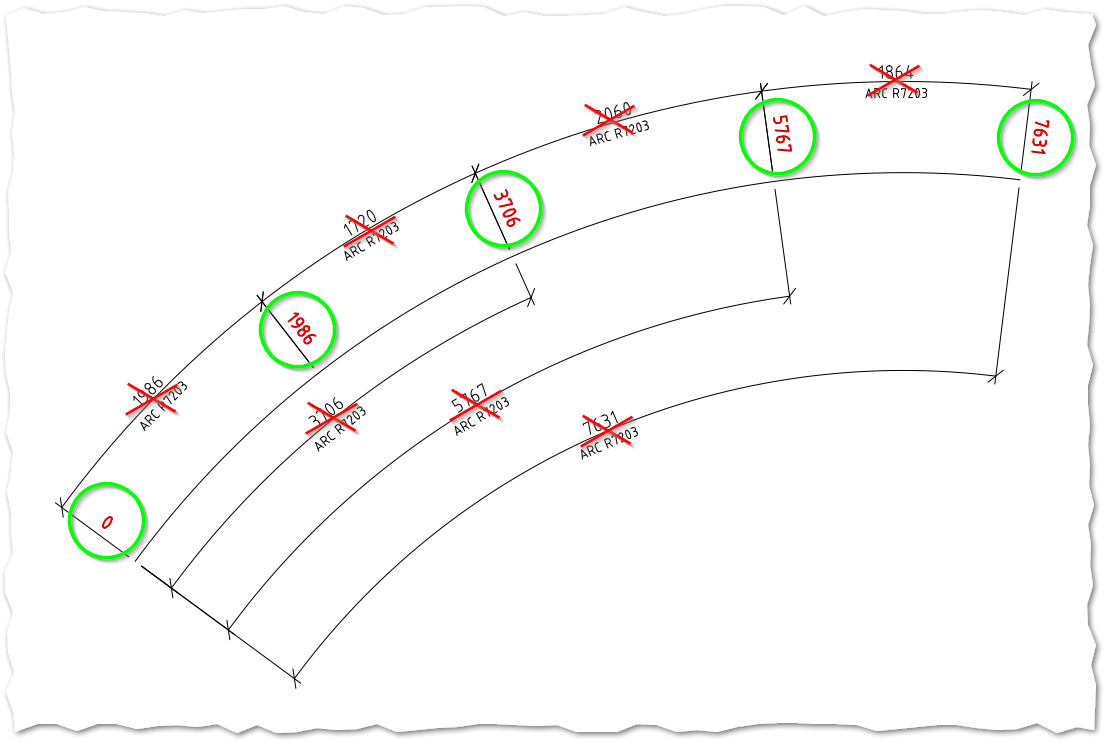

Hey guys,
Quite sure ACAD doesn't support this natively - so figured I'd ask here.
Just wondering if anyone knows of a way (or has a custom routine) that will add running dimensions to ARC dimensions?
I use a routine to create the ARC dimenions (different to ACAD's DIMARC command - code below).
Is it possible to create ARC RUNNING DIMENSIONS?

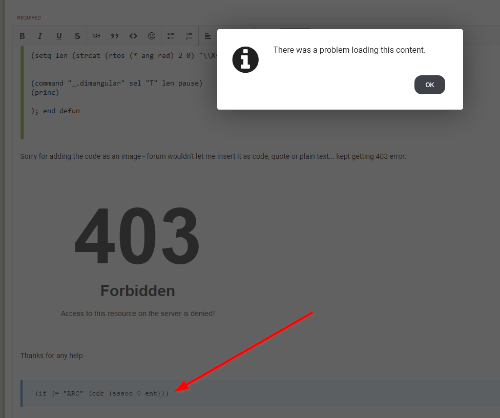

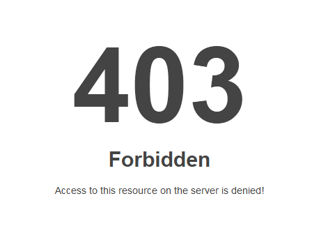

Sorry for adding the code as an image - forum wouldn't let me insert it as code, quote or plain text... kept getting 403 error:

The forum seems to be rejecting a single line of my code:
Sorry for the spam guys

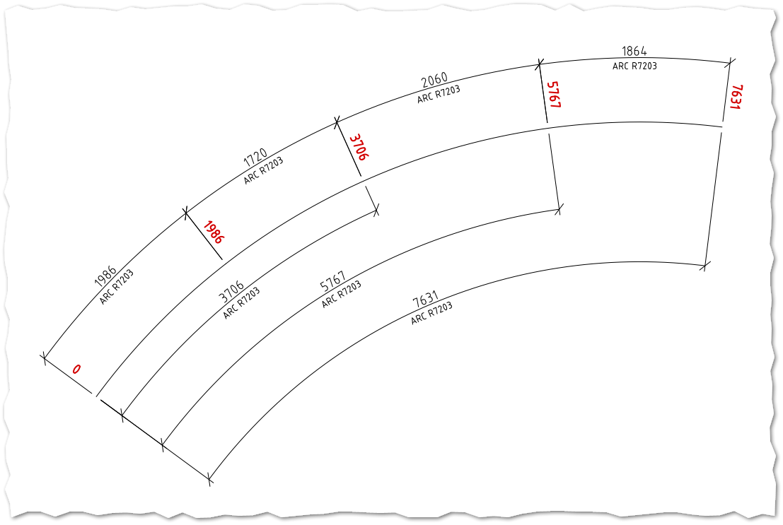

My ARC dimension routine works by picking a single ARC for each dimension.  I don't really have a method for DIMCONTINUE for ARCs - it's really one-at-a-time.
In the example, there are 4 ARCs (in line), and I would like to attempt to add a running dimension for the total of these 4 ARCs.
Having a tricky time explaining it - hopefully I'm not confusing everyone.

Hey BIGAL,
Thanks for the reply.
Quote
To use dimangular you pick object so need a single arc
I agree and understand - my 'DIMARC' routine is based on picking a single ARC.
I'm afraid I'm still not really following your instructions through, please see sketch below.  I am attempting/hoping to create the running dimensions around an ARC - the numbers highlighted by the green circles below.  Is this what you are describing?
The green numbers are a bit easier to work out, if you pick the arcs in order then each arc has a Arclength note not length as a property, so its easy to work out the running chainage.
Its probably easiest to just pick and write the answer.
