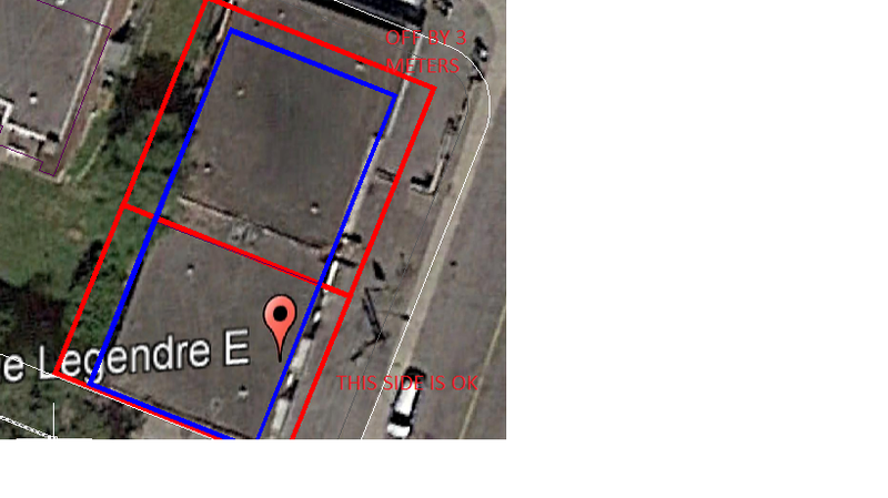

map doesn't match georeferenced dwg
Neither file (DWG / DXF) appear to have a coordinate system assigned.

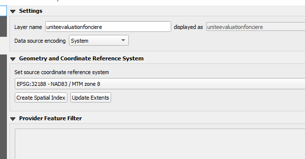

When I add vector layer in qgis and look at the property of that layer i get this see image.

I'm still lost on how to overlay online map on dwg. However when I assign coordinates system to my dwg(i didn't use geographic location command), i'm ok.
I assume, that by exporting dxf from qgis, dxf has already coordinates system assigned.The reason i believe so, is the property of that vector layer..see image above.
Expand
In AutoCAD Map3D, you need to use the ADESETCRDSYS command to assign the coordinate system to the DWG.  If you are confident QGIS has found the right system you can try assigning it, otherwise consult a surveyor.  Once you have the proper system assigned (assuming the coordinates of the drawing are correct) you will be able to merge external information, export, etc.
