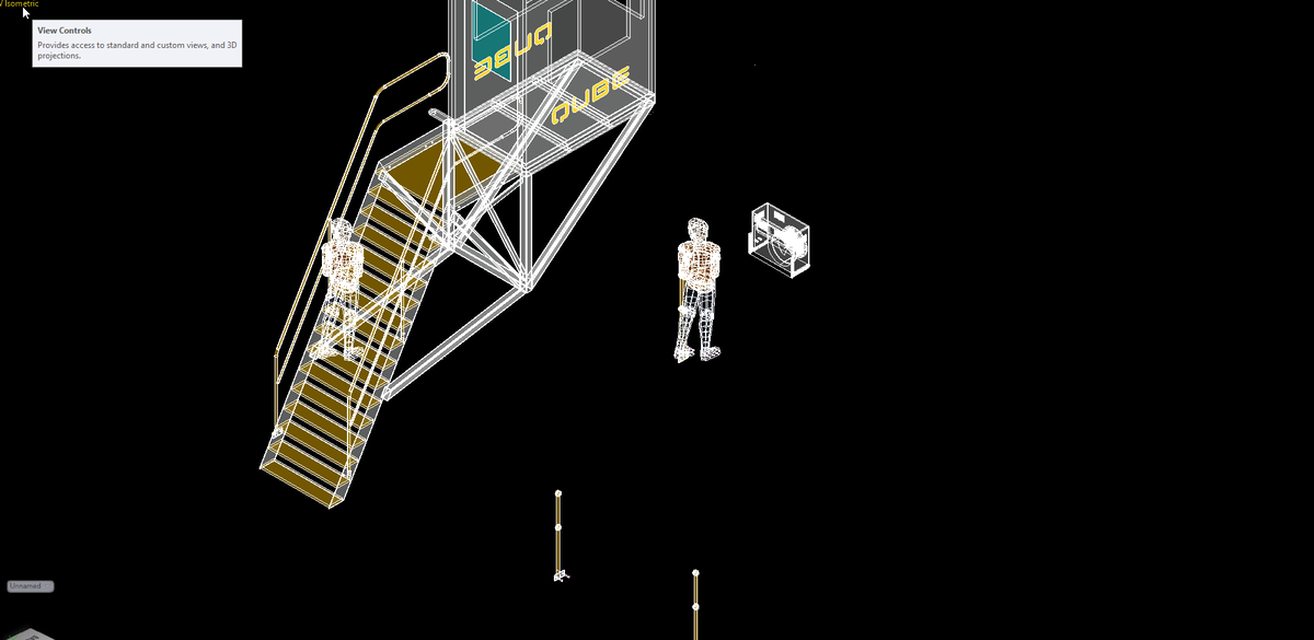

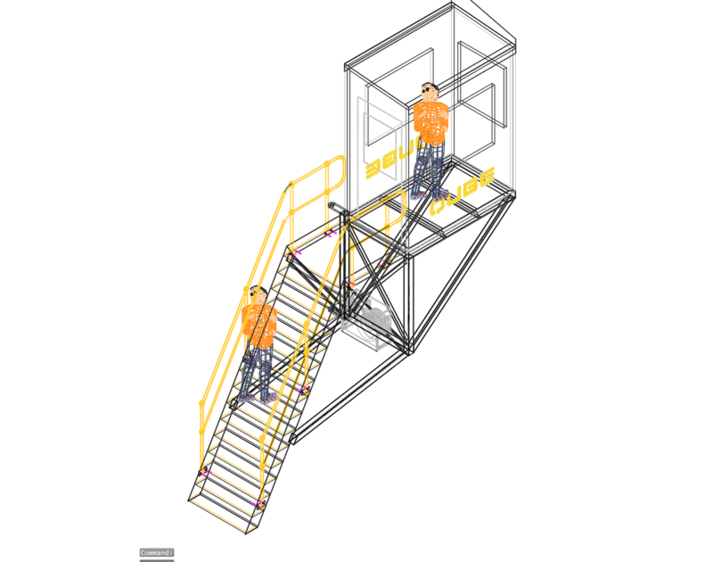

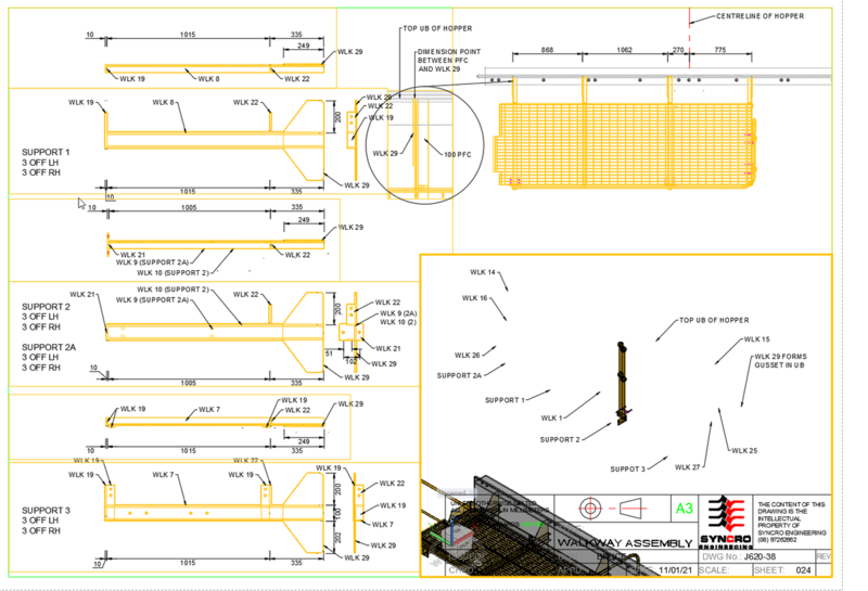

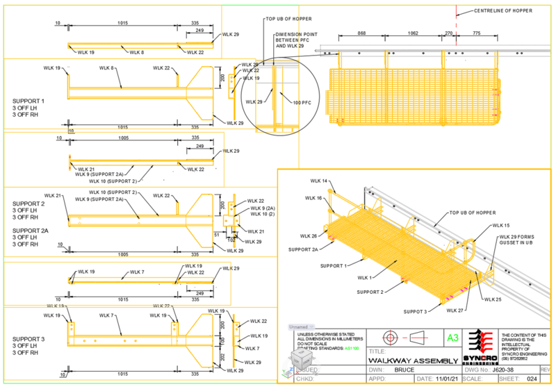

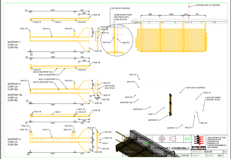

I'm having continued issues, while I do most of my work in wireframe occasionally I need to view in shaded, conceptual or some other visual style. On this job it has started displacing items and generally making the view unusable. The file size is 26476KB. If I chose to print a view port in a different visual style the print preview shows parts displaced but the print shows all parts correct.  I have attached some screen shots to show the issue.
I need to be able to show individual parts for cutting, grouped parts for component assembly and overall  assembly of components 1371084403_viewportinx-raystyle.thumb.png.d19c2de6553a1388e797e59264f2332c.png673277723_viewportin2Dwireframe.thumb.png.5a10e5128c95e75abfe4c65b8a45eb65.png1525571027_printpreviewviewportsetprintx-raystyle.thumb.png.b80fe073b1f55cca3094faff5fe4708e.png621967047_taskmanagerwireframe.thumb.png.fb51cf6b87d9a083029cd352b7323747.png1820123164_taskmanagerx-ray.thumb.png.a06f9dcb52da6b96ea618e0ca0b6d290.png1425406758_computerspecs.thumb.png.daefa2a8983c98f16a6f56d240b56e08.png57190899_morecomputerspecs.png.908aed6f0ae6ade1da42c45807e98cfe.png972108401_modelspacex-ray.thumb.png.8e65dffe7a7f992d91a68f72dc6359e0.png1432004269_modelspacewireframe.thumb.png.a1f7d8761e46dcd5f135ef809d16332b.png
Edited by bruce13557
Are you using any XREF's that are PDF attachments?
In the viewport that is causing hiccups, if you look closely on your screenshot the viewport is active and you can see the WCS on the bottom left of the active viewport.
This may be causing memory issues when you go to print - especially given the size of the file.
Make sure your viewports are inactive in paperspace before plotting/publishing and locked for posterity.
There are a few different ways/tricks to make the file size smaller.  Given the size of the DWG I would definitely go step by step to utilize those options in an effort to lower the overall size.
These options include, but are not limited to...
1 - block out assemblies into other DWG files.  There are LISP routines that can do this for you.  You select what you want to block out, it will save that content as a separate DWG at the same coordinates using the same layers.  it just brings up a dialog for where u want to save the new block and automatically replaces the selection set with the new block.  OR you can manually block out each assembly/subassembly.
2 - to save your memory, freeze layers that you can to remove them from active memory.  It won't lower the file size, specifically, but will help.
3 - purge all - There's multiple ways to do this but easiest is probably the purge command, then use the purge all button in the dialog box (may need multiple runs).
4 - if you absolutely need to you can lower the overall file size by saving as an earlier version DWG.  2004 DWG can sometimes cut the file size almost in half (just depends).  But I would avoid this in your case unless absolutely necessary.  The good thing is you can test this on a copy of your DWG to see what the file size reduction would be and ensure everything is working as intended - safely - before you actually apply the changes to your working files.
If you notice, in your viewport that is problematic, it is using a realistic visual style.
This implies your model space is using realistic visual style when it really doesn't need to.  Your visual style I would set up to be viewport specific with wireframe being default in model space (if that makes sense).
This way, your viewports can be realistic or 3d hidden, etc... on the sheets.  But your model space is always 2d wireframe using less system resources.
-ChriS

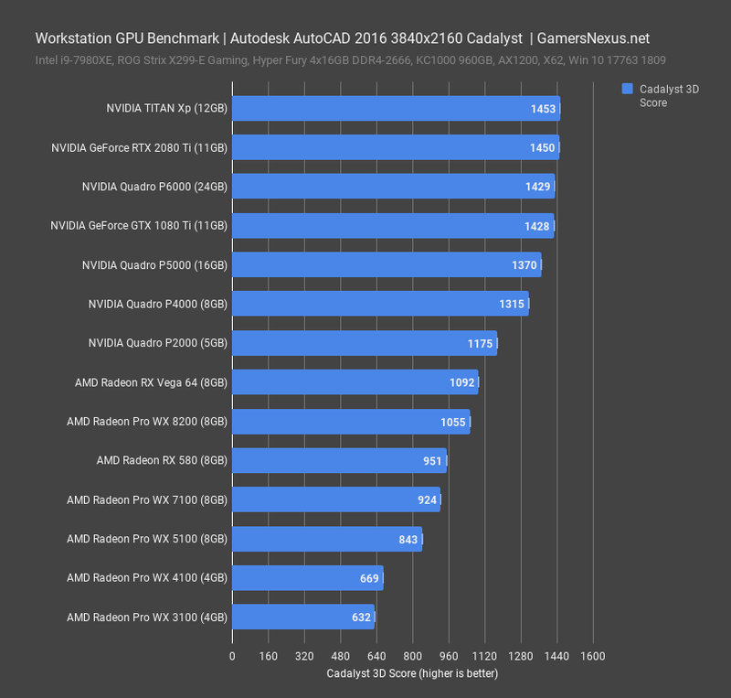

  On 11/21/2020 at 1:18 AM, f700es said:
Nope, I’ll post some results that show GeForce cards out performing Quadro cards in AutoCAD.
Expand
workstation-gpu-benchmark_autodesk-autocad.thumb.png.4a58f618c024f543c4d780d9cb316a05.png
Of course the Quadro cards which have the most RAM for large files are every single Quadro card is manufactured internally by NVIDIA, whereas GeForce cards are often built and sold by third-party vendors. NVIDIA keeping the Quadro cards isolated in this way ensures a consistent level of quality, which is important to businesses that are always looking for a stable, long-term solution. In that vein, Quadro cards also offer longer warranties, enhanced IT management capabilities, and even come with drivers that are designed with longevity in mind. Basically, they come with all the features you’d want in a professional environment.
