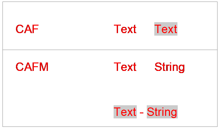

asos2000 Posted September 17, 2019 Share Posted September 17, 2019 Give attached a try command CAF or CopyAsField To Link between a Text and another one And CAFM or CopyAsFieldMulti To Link between 2 Texts with separator and another one CopyAsField.lsp Quote Link to comment Share on other sites More sharing options...
