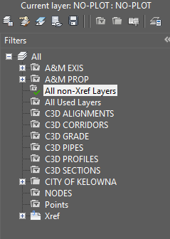

Therefore the lisp is erroring, and in my test, unless things have changed since my version (2012), inserting a drawing as an xref does not create the "All non-Xref Layers" filter, rather and "Xref" filter. This should be the first port of call.
I'm using 2016.
Drawing without Xrefs
Drawing WITH Xrefs

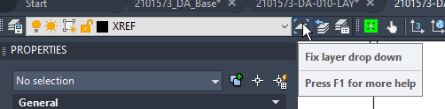

On 07/09/2019 at 02:53, Silvercloak said:
Hi all,
   This has been driving me ape for years.  I'll open a drawing, and get working in it.  Realize I need to change layers, so I'll click on the layer dropdown only to discover it's locked into an xref.  I'll have to open the entire layer manager dialogue JUST to switch to non-xref filter.  Seriously, why are xrefs even showing in the drop down?  You can't draw on those layers or do anything with it.  Stupid programming design.   Anyways, ranting aside, I've tried to write a scripted button to switch the filter using the -Layer command but once I get to setting the filter it doesn't really accept "All non-xref layers" as a filter choice.   Leaving me going back to opening the layer manager dialogue box just to change the frigging filter so I can use the dropdown.
   Does anyone know how to make a working script for this or is there some kind of fix?
Silvercloak
I could not agree more. This has been driving me crazy for years too.  So stupid to even list xref layers in this drop down. Thanks to Aftertouch's routine, I was able to add the routine to a toolbar button and then create a clone of the standard layers toolbar and now I have the fix sitting right next to the layer drop down so whenever this problem comes up, which is all the friggin time, there is a quick fix sitting right next to it. We should not need to be doing these work arounds however. Autodesk should be using our huge licence fees to fix these problems that are just downright annoying to users.
