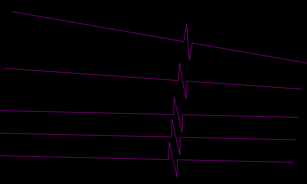

can any body write a lsp routine of break line symbol which will draw break line symbol in multiple polyline at once.
How do I know where to draw the break?  You should still select a point for every polyline.  Or do you have another solution in mind?

Should get you started, scaled to current Annotation Scale at picked point.  Icon with transparent background attached.
A suggestion when you get point and select object put its entity name to a list, when you break get (entlast) add the 3 lines put entity names to list you can use join to make back into a pline with a zig/zag.
Tombu code did not work ? Something to do with cannoscale maybe. How long a line or pline segment ? Set cannoscale to 1:x ? Changed dimscale etc etc
Command: BRKLNSYM
Break Point: ; error: bad argument type: numberp: nil
I usually just ask for break distance and offset.

It's designed to place the breakline symbol on an existing line, polyline or arc.  You have to pick one of those same as with the BREAKLINE (Express Tool), guess I need to add error checking. The breaklines display the same in Paper Space as they do inside a Viewport using the CANNOSCALEVALUE value (not CANNOSCALE) unless you change the Annotation Scale afterwards.
  On 9/4/2019 at 12:06 PM, pmadhwal7 said:
please check my attached dwg
Expand
Without a Layout with a Viewport it doesn't appear you're using Annotation Scale, but setting the Annotation Scale to 1:5 seemed to work.  As I'm not familiar with Metric drawings or plotting from Model Space that's the best I can offer.
Expand
Ah, I see.  Then this should work.
- Set as current layer the layer of the breaklines
- Command MBL (for Make Break Lines, see bottom function)
- Select the blue polylines.
(I attached a dwg containing only the blue polylines, for testing)

Emmanuel a suggestion rather than pick p1p2 drag a line over the two plines near an end what this allows you to do is to compare the two plines and if required swap the start and end pts so both plines are considered in same direction as your doing already pt1 ->endpoint ->startpoint. A little operator easier you can use (ssget "F"  (list pt1 pt2) ) …… removes osnap problems and gets you to the two plines. Add a while so can repeat. Could do pick pline and get layer so other objects are not considered in ssget.
The start and end using vl is a  function  no need for co-ordinates. Note does not work on lines.
(setq stpt (vlax-curve-getstartpoint obj)) ; (25867.7091634096 55028.4440727107 0.0)
(setq endpt (vlax-curve-getendpoint obj)) ; (25929.6833934434 55030.1799066927 0.0)
You need also to add drawpoly defun its missing we all do that forget something that's needed.
Maybe this also so not hard coded run only once before while then others can use with different values.
(if (not AH:getvalsm)(load "Multi Getvals.lsp"))
(setq ans (AH:getvalsm (list "Enter values" "Gap         " 5 4 "1" "Angle" 5 4 "70" "Extend" 5 4 "0.2" )))
returns a list  ("1" "70" "0.2")

    ;; we should have pairs now. draw the break lines
    (setq pl
      (drawLWPoly
        (bl 1.0 (angle ps1 mps) ps1 mps 0.18)
        0
    (setq pl
      (drawLWPoly
        (bl 1.0 (angle pe1 mpe) pe1 mpe 0.18)
        0

; error: no function definition: DRAWLWPOLY
Oops sorry, I didn't copy/paste all the code.
EDIT: use this code on top, I shortened it, using one of BIGAL's suggestion
(defun drawLWPoly (lst cls)
  (entmakex (append (list (cons 0 "LWPOLYLINE")
                          (cons 100 "AcDbEntity")
                          (cons 100 "AcDbPolyline")
                          (cons 90 (length lst))
                          (cons 70 cls))
                    (mapcar (function (lambda (p) (cons 10 p))) lst)))

;; break line - returns the 6 points
;; gap: the gap between the aligned lines, interrupted by the diagonal lines
;; ang: angle
;; ps - pe: start point - end point
;; ext: distance to extend the aligned lines, from ps or pe
(defun bl (gap ang ps pe ext / pm p1 p2 p3 p4)
  ;;(setq ps (list 0.0 0.0 0.0))
  ;;(setq pe (list 5.0 0.0 0.0))
  (setq pm (mid ps pe))
  (setq lg (* gap (/ 0.25 (sin (dtr 20))) ))  ;; length of the small diagonal piece of line
  (setq p1 (polar pm ang (/ gap -2.0) ))                ;; half the gap to the left from the midpoint
  (setq p2 (polar p1 (- ang (dtr 70.0)) lg))            ;; 70° down-right (length = lg)
  (setq p3 (polar p2 (+ ang (dtr 70.0)) (* 2.0 lg)))    ;; 70° up-right (length = 2 x lg)
  (setq p4 (polar p3 (- ang (dtr 70.0)) lg))            ;; 70° down-right (length = lg)
  (list (polar ps ang (* -1. ext))  p1 p2 p3 p4 (polar pe ang ext))
(defun c:testbl ( / ps pe pl)
  (setq ps (getpoint "\nPoint 1: "))
  (setq pe (getpoint "\nPoint 2: "))
  (setq pl
    (drawLWPoly
      (bl 1.0 (angle ps pe) ps pe 0.18)
      0
;; MBL for Make Break Lines
;; assuming the polylines don't have reversed order of vertices, we look for the closest start points (vertex 1) of 2 polylines.  This means we have a match.
(defun mbl (ext gap / ss i pline1 pline2 ind dist ps1 ps2 pe1 pe2 mps mpe lst pts pl)
  (setq i 0)
  (princ "\nSelect the blue polylines: ")
  (setq ss (ssget (list (cons 0 "POLYLINE,LWPOLYLINE"))))
  (while (> (sslength ss) 1)
    (setq pline1 (vlax-ename->vla-object (ssname ss 0)))  ;; why not start with the first
    (setq ps1 (vlax-curve-getstartpoint pline1))
    (setq pe1 (vlax-curve-getendpoint pline1))
    (setq i 1)  ;; skip 0, we don't need to compare the same polyline
    (setq ind nil)
    (setq dist 0)
    (repeat (- (sslength ss) 1)
      (setq pline2 (vlax-ename->vla-object (ssname ss i)))
      (setq ps2 (vlax-curve-getstartpoint pline2))
      (setq pe2 (vlax-curve-getendpoint pline2))
      (if (or (= ind nil) (< (distance ps1 ps2 ) dist) ) (progn
        (setq dist (distance ps1 ps2 ))
        (setq ind i)
        ;; remember the matching start and end points
        (setq mps ps2)
        (setq mpe pe2)
      (setq i (+ i 1))
    (setq pl
      (drawLWPoly
        (bl gap (angle ps1 mps) ps1 mps ext)
        0
    (setq pl
      (drawLWPoly
        (bl gap (angle pe1 mpe) pe1 mpe ext)
        0
    ;; now remove the two from the ss selection
    (ssdel (ssname ss ind) ss)
    (ssdel (ssname ss 0) ss)
(defun c:mbl ( / ext gap )
  ;; settings, feel free to change these numbers
  (setq ext 0.18)
  (setq gap 1.0)
  ;; invoke the main function
  (mbl ext gap)
    (setq pl
      (drawLWPoly
        0
    (setq pl
      (drawLWPoly
        0
  (setq ext 0.18)
  (setq gap 1.0)
  (mbl ext gap)
(defun c:mbl ( / ss i pline1 pline2 ind dist ps1 ps2 pe1 pe2 mps mpe lst pts pl)
  (setq i 0)
    ;; extract its points
    (setq lst (vlax-get pline1 'coordinates))
    (if (= "AcDb2dPolyline" (vla-get-ObjectName pline1))  ;; polyline or 2D polyline ?
      (setq pts (3d-coord->pt-lstrjp lst))
      (setq pts (2d-coord->pt-lst lst))
    ;; start point & end point:
    (setq ps1 (nth 0 pts))
    (setq pe1 (last pts))
    (setq ind nil)
    (setq dist 0)
      (setq lst (vlax-get pline2 'coordinates))
      (if (= "AcDb2dPolyline" (vla-get-ObjectName pline2))  ;; polyline or 2D polyline ?
      (setq ps2 (nth 0 pts))
      (setq pe2 (last pts))
        (setq ind i)
        (setq mps ps2)
        (setq mpe pe2)
      (setq i (+ i 1))
    (setq pl
      (drawLWPoly
        0
    (setq pl
      (drawLWPoly
        0
Expand
Wow great thanks sir it will save my lots of time....many thanks
  (setq pl
    (drawLWPoly
  (setq i 0)
    (setq ind nil)
    (setq dist 0)
        (setq ind i)
        (setq mps ps2)
        (setq mpe pe2)
      (setq i (+ i 1))
    (setq pl
      (drawLWPoly
        0
    (setq pl
      (drawLWPoly
        0
Expand

Okay, I have mbl for the blue lines, msbl for the red lines.
The olny thing: it doesn't extend the left break line to the same height as the right break line necessarily, I hope that's okay
  (setq ext 0.18)
  (setq gap 1.0)
  (mbl ext gap nil)
;; make Scale Break Lines
(defun c:msbl ( / ext gap roundup)
  (setq ext 0.5)
  (setq gap 1.0)
  (setq roundup 2.0)
  (mbl ext gap roundup)

      ;; ps is bottom
      (setq pe (list (nth 0 pe) (+ (nth 1 ps) newlength)))
      ;; pe is bottom
      (setq ps (list (nth 0 ps) (+ (nth 1 pe) newlength)))
  (setq pl
    (drawLWPoly
      (bl 1.0 (angle ps pe) ps pe 0.18 nil)
      0
(defun mbl (ext gap roundup / ss i pline1 pline2 ind dist ps1 ps2 pe1 pe2 mps mpe pl ptemp)
  (setq i 0)
    (setq ind nil)
    (setq dist 0)
      ;; in case endpoint and startpoint are reversed (top pline is drawn from left to right, bottom line is drawn from right to left), we may have to swap ps2/pe2
      (if (< (distance ps1 pe2 ) (distance ps1 ps2 ) ) (progn
        ;; swap.
        (setq ptemp pe2)
        (setq pe2 ps2)
        (setq ps2 ptemp)
        (setq ind i)
        (setq mps ps2)
        (setq mpe pe2)
      (setq i (+ i 1))
    (setq pl
      (drawLWPoly
        (bl gap (angle ps1 mps) ps1 mps ext roundup)
        0
    (setq pl
      (drawLWPoly
        (bl gap (angle pe1 mpe) pe1 mpe ext roundup)
        0
  (setq ext 0.18)
  (setq gap 1.0)
  (mbl ext gap nil)
  (setq ext 0.5)
  (setq gap 1.0)
  (setq roundup 2.0)
Expand
works fine but as you said it doesn't extend the left break line .... its ok for me i will manually extend them thanks a lot for all sir can you also help me on my other topic...if you don't mind...
