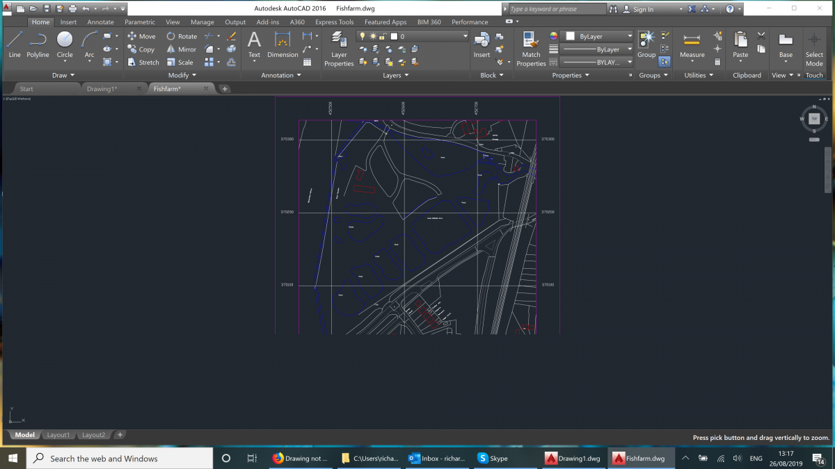

Drawing not displayed fully in zoom extent.
All the drawing I have display the same issue. When I open them and zoom to extents, only about 2/3 of the drawing is displayed. Its like the display is the wrong size. I can pan to see the rest of the drawing and select all will select everything. The same applies if I statrt a new drawing before drawing anything
What have I done wrong?

How are you zooming extents? and if you read the values of the variables extmin and extmax and draw a rectangle using those values, what does it look like.
Are there blocks involved?  Has the view been twisted?  Is REGENAUTO on?  Do the same drawings behave the same on another PC?
Is it possible that you have a toolbox open on one side? If it's not docked, it will obscure part of the drawing area. Can you move any of your toolbars? Are there gaps between any toolbar and the window border?

This is the drawing with Zoom Extents used, it occupies the top portion of the screen but the lower third is blank. If I pan, the rest of the drawing becomes visible.

Hmmmm, it's something on your end. I opened the drawing and double-click my scroll wheel (to zoom extends) and it does just that.
The mystery deepens it seems.....
  On 8/26/2019 at 1:33 PM, richard.splashm@gmail.com said:
I would be happy to.
Expand
It was already zoomed to extents when I opened it. Text at top and bottom were to the edge of the screen.
Does this version work OK for you. It might not fix the issue, but the content in your drawing is an awful long way from the 0,0 origin and that can cause issues with ACAD, if this drawing zooms OK then that is your problem (otherwise it's something else). You may well need the objects placed as they are for georeferencing or something similar, but be aware it can cause problems.

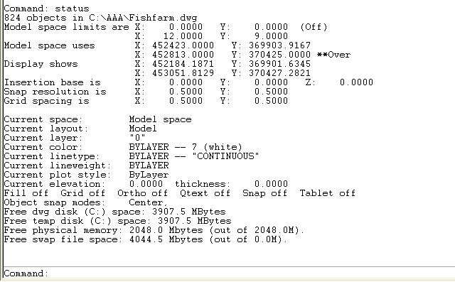

The command STATUS is useful.
However this does not solve the problem.
