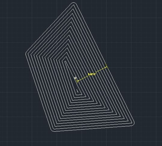

How can I determine (via lisp) The Greatest Distance a closed polyline can be offset inboard.
As the title says, I would like to determine the maximum distance a Closed Polyline can be offset inboard.

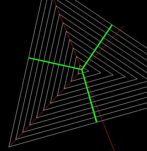

I thought I could do this by using the Centroid point. As you can see from the attached image The centroid point is not the true geometric center.

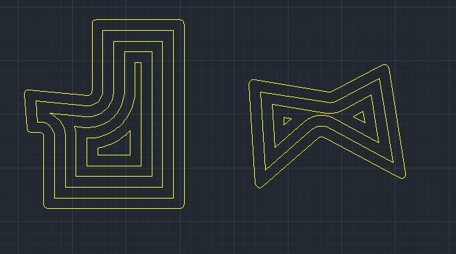

It also occurred to me that while this may work on simple polygons, it would not work on shapes that "subdivide" as they are offset.
The best way I can think of currently would be to find the largest circle that can be inscribed within the polyline, which would be very difficult to determine automatically in complex shapes. Is there a simpler method? Or does anyone have a method of finding the largest inscribed diameter?
The centroid point is, by definition, is the true geometric center but I don't think the solution to your task has anything to do with the centroid.
I think the approach to take with a VLISP program is to use an iterative approach with the offset command.  After selecting the closed polyline a point needs to be specified that is inside the polyline. This might not be the centroid (the centroid for the letter "C" is not inside its profile). The program should make a guess for an offset and if successful another larger value for the offset could be tried until the result is not successful. Offset outputs the message "Cannot offset that object." if it cannot make an offset. AT this point the program could systematically try smaller values until a valid offset is created.  I do not know how to check for the output error message in VLISP.  If you can determine that I think I could write the program.

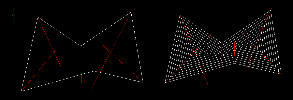

I may be guessing but if ignore fillets if you take a the poly shape and do a 1/2 angle of the corners where they intersect is the maximum then perp check. No real idea where to start.
