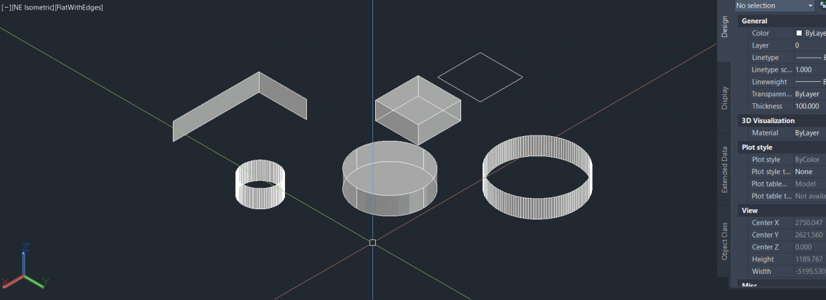

BIGAL Posted August 24, 2019 Posted August 24, 2019 (edited) Flat circles do not shade add a thickness but it only shades edges. same with lines or extrudes etc. 2020 Edited August 24, 2019 by BIGAL Quote

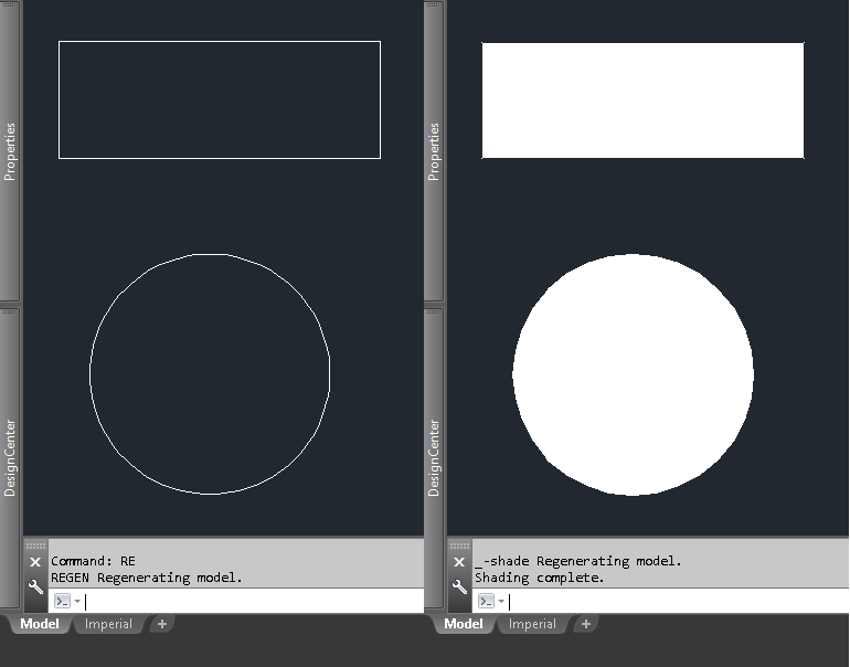

steven-g Posted August 24, 2019 Author Posted August 24, 2019 This is what I get in 2017LT for a circle and a region, UCS=world and plain plan view, from 2018LT onwards the shade command just gives me a blank screen and the error message about not enough free RAM. Quote
BIGAL Posted August 24, 2019 Posted August 24, 2019 Interesting a pline nothing a region yes CIV3d 2020 Quote
