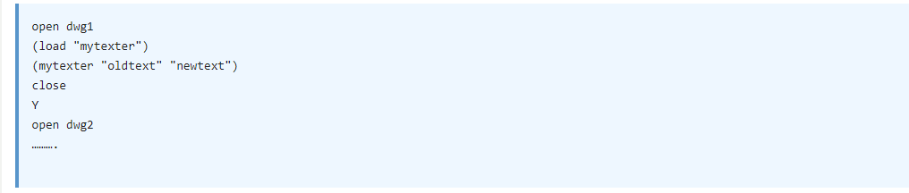

learner1230 Posted August 22, 2019 Posted August 22, 2019 hi , i have approximately 1000 dwg files in my folder , and i have to run a lisp in all of those files , is there any easy way script or macro for open files / run commands which i want / save & close file / open next dwg and the same procces for until finish all files ... I tried a lot of exaples of script but nothing match thank you for your help Quote

BIGAL Posted August 25, 2019 Posted August 25, 2019 (edited) You could read a csv file dwgname,oldtext.newtext and write the script file. You would pass the variables to a lisp (load "mytexter") (mytexter "oldtext" "newtext") open dwg1 (load "mytexter") (mytexter "oldtext" "newtext") close Y open dwg2 ………. Edited August 25, 2019 by BIGAL Quote
learner1230 Posted August 26, 2019 Author Posted August 26, 2019 hello, I tried this like a .scr , but it just opend the file without replacing the text and saving Quote

BIGAL Posted August 27, 2019 Posted August 27, 2019 Mytexter does not exist it is the name of your lisp file that you want to use to replace the text. Same with the new old text. I have no idea where the text is that you want to replace. A question to Maratovich can we populate the new old from the excel noticed a button ? Quote
