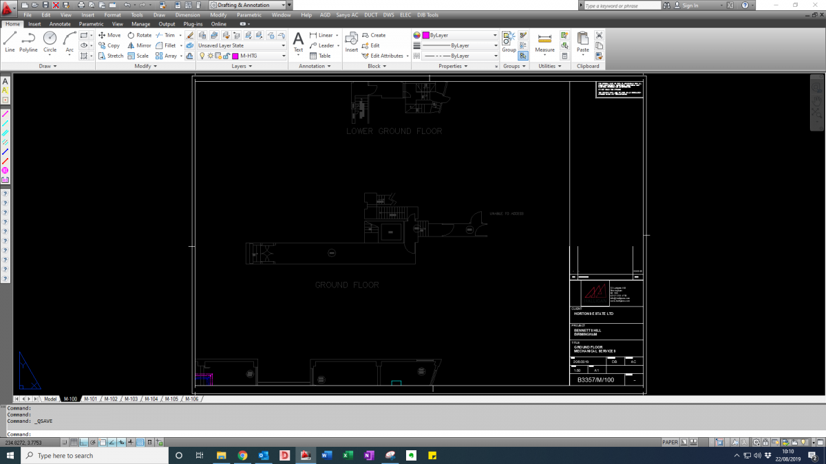

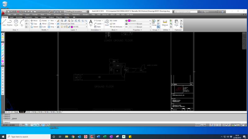

AutoCAD LT refuses to display file path in full screen mode. I have it switched on and it works correctly if I reduce the AutoCAD window from full screen mode. How do i display it in full screen mode. See attached screenshots. Many thanks in advance.

Well, there is your answer and pretty much what I was suspecting. When AutoCAD LT 2012 came out, Windows 10 was not released, I believe AutoCAD 2015 was the first that was supported.
IIRC, you will need to adjust your screen resolution and probably a few more things to address in Windows 10, maybe using DirectX 9 instead of the latest DirectX on Windows 10. There is a chance a different Graphics Driver might help. You would be best searching on the Windows 10 Forums.
