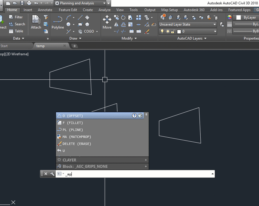

loudy000 Posted August 21, 2019 Posted August 21, 2019 hey guys, i have a little knowledge on c#, basically i want to do something like foreach(Polyline pl in selected polylines) { ///do something }; but i dont have any idea how to do it using lisp. this is the command i want to run for each polyline (command "_MAPCreateFeatureFromGeometry" "yes" "landuse" "") ) thanks in advance. Quote

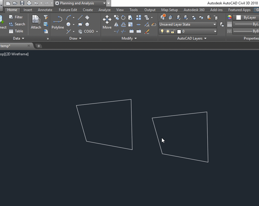

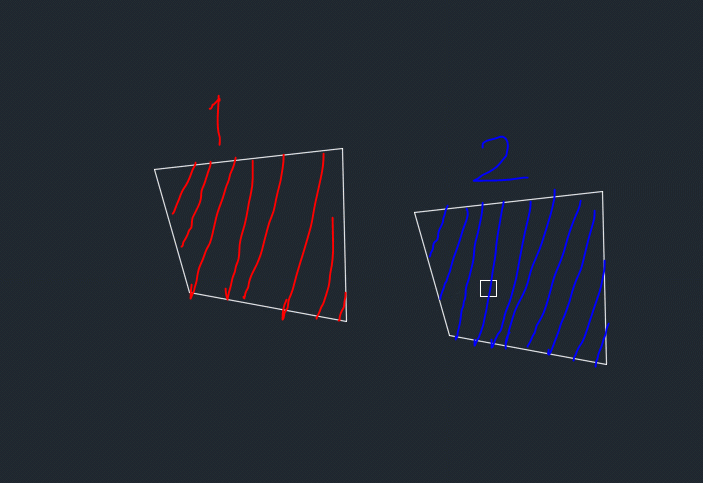

loudy000 Posted August 23, 2019 Author Posted August 23, 2019 Thanks @Tharwat however i still cant get it to work, sorry it's kind of difficult to explain what the command does.. Please see attached. so thats basically i want to run on multiple polylines as separate (fill) Thanks again. Quote

loudy000 Posted August 24, 2019 Author Posted August 24, 2019 (edited) 10 hours ago, Tharwat said: Can you post the working C# codes so I can convert them into lisp if they are not that complicated? You did not show the command line if the codes throw any error to allow me to know how things going on with the codes.! Hi @Tharwat technically there's no actual c# code it's just an example of what im after, i think it's close just need to create separate hatch for each poly line. So say select 3 or 4..poly lines and create hatch for each. Edited August 24, 2019 by loudy000 update attachement Quote
