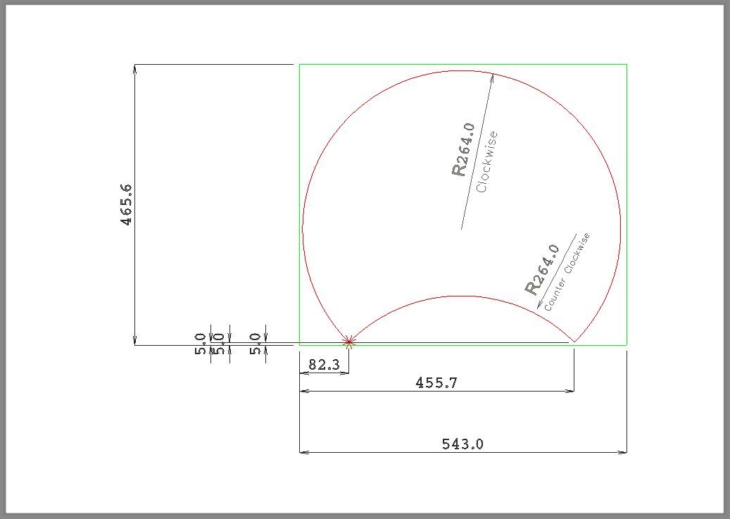

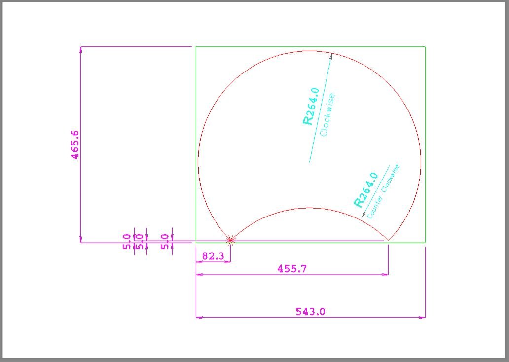

Gali Posted August 20, 2019 Share Posted August 20, 2019 Hello every one Why my plot style is not reflected in the preview ? Image 1 is the drawing Image 2 is how it should preview and print . the CTB all black except red and green . Is there problem in my basic congratulations ? please help me how to make my plot style appear in the preview ! Thank you in advance . Quote Link to comment Share on other sites More sharing options...
CyberAngel Posted August 20, 2019 Share Posted August 20, 2019 Sorry, I don't understand your problem. If the CTB has green and red pens, and your plot has green and red objects, it sounds like you got what you wanted. If I had to guess, there are two potential problems. One, you don't want the green and red objects. In that case, check the properties of the objects themselves for color overrides. Then check the colors assigned to your pens and make sure they're all black. Two, you don't want the black objects. Check the colors in your color table and make sure they're not black. If this doesn't help, please provide more information. The more you can tell us, the better we can help you. Quote Link to comment Share on other sites More sharing options...
tombu Posted August 20, 2019 Share Posted August 20, 2019 Is Display plot styles checked in the Page Setup? We have one person in our office still using a CTB file and while Red is set to plot black it still displays as Red even with Display plot styles checked though it plots correctly. I've never had an issue like that with an STB file. Quote Link to comment Share on other sites More sharing options...
