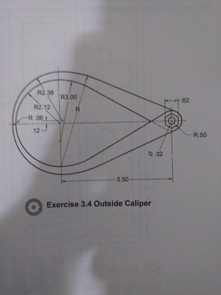

Need help in drawing exercise
I'm quite loss on how to draw the left side on the drawing. I need some guidance on how to draw it.
You will need to draw several circles. Connect the circles with lines using the Tangent-Tangent snap. Use the lines to trim the circles. Some of the dimensions you will need are missing, but you can calculate them using the numbers you do have.
Post a copy of what you have drawn so far.  I'm not sure you can calculate all the missing numbers needed to fully construct the drawing in question.  But that's just my opinion.  I could be wrong.
The inner upper edge can be easily created with circles of R2.12,  R3, and R.5. then adding a line tangent to the R3 and R.5 circles.

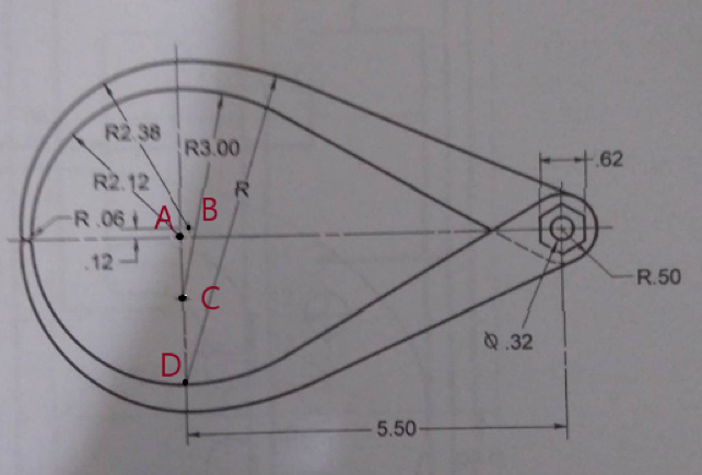

The outer profile may need the assumption that R is center at a point 2.12 below A. Draw a circle of R2.38 centered at B.  Now draw a line through D and B. The intersection of this line with the R2.38 circle can be used to determine the value of R.   Draw a circle of radius R centered at D then a line tangent to it and the R.5 circle.

How would you arrive at B?
Expand
Good question! Fudge an x coordinate, perhaps 0.12 from A.  Not the best drawing exercise.
0.12 the height above A is given and the same to the right (R0.06 at the outer edge is given)
I think that it can be derived from drawing, and I reckon it is 0.14004985 to the right.
I would draw the figure by starting with the 2.12r circle.
Then by offsetting this circle and the centre line by 0.06 each to get the centre of the 0.06 circle.
Then draw the 0.06r circle and offset this circle by 2.26, and where this intersects with an offset of 0.12 from the centre line, is point B.
It works best for me if I assume the dimensions shown have been rounded, so instead of .12 I use .125, instead of .06 I use .0625, instead of 2.38 I use 2.375.
That would be the easiest way to go.
Unfortunately, with these exercises, there is a note:- 'If dimensions are given, create your drawing geometry exactly to the specified dimensions.'
Expand
I derived B with parametrics.  After drawing the arc of 2.12 I drew the .06 circle close by where it will go, set some parameters so the existing arc and line wouldn't move, set the .06 circle tangent to the arc and horizontal line.  Then I drew a 2.38 circle close to where it goes, set the left side of the circle tangent to the left side of the .06 circle, then set a coincident paramenter for the center of the 2.38 circle and the horizontal line set above the center line by the given amount of .12.  The distance to the horizontal center line is .14002743.

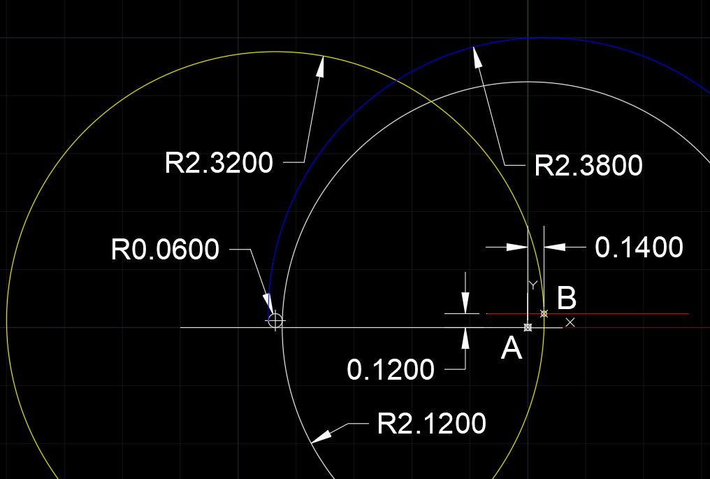

If you assume that the R0.06 radius is tangent to the horizontal centerline then you can use circle TTR to position it as shown below. (tangent to the line and the R2.12 arc).  We know the y coordinate of B is 0.12.  The x coordinate can be found by drawing a concentric circle of R 2.32 ( = 2.38 - 0.06) to the 0.06 circle. The intersection of this circle and the 0.12 offset line is the location of B.
Yeah when you draw it out then 0.14 makes good sense. And it doesn't need any other dimensions than those given.

I respectfully disagree. It is an exact solution.
Centering a circle of R2.38 (blue) anywhere on the circumference of the R2.32 circle (yellow) will position the circle tangent to the R0.06 circle. I agree that since B is above the center of the R0.06 circle the tangent point will be below its center (consistent with my post).  Why did you mention quadrant?
