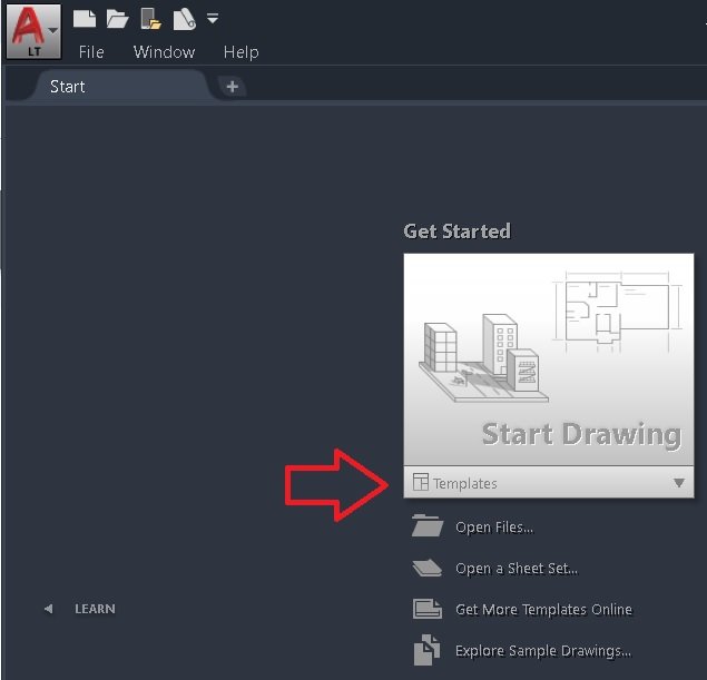

steven-g Posted August 16, 2019 Share Posted August 16, 2019 When you first start up AutoCAD try choosing a metric template to start with, click on the templates dropdown and choose the acadiso.dwt file this is the metric template. For your second problem a screenshot would help. Start the rectangle command and pick your first corner and when AtoCAD asks you for the second corner that would be a good place to take the screenshot so we can see how your screen looks before you pick a second point. Quote Link to comment Share on other sites More sharing options...
steven-g Posted August 16, 2019 Share Posted August 16, 2019 You'll find the template files here. Quote Link to comment Share on other sites More sharing options...

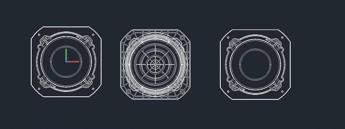

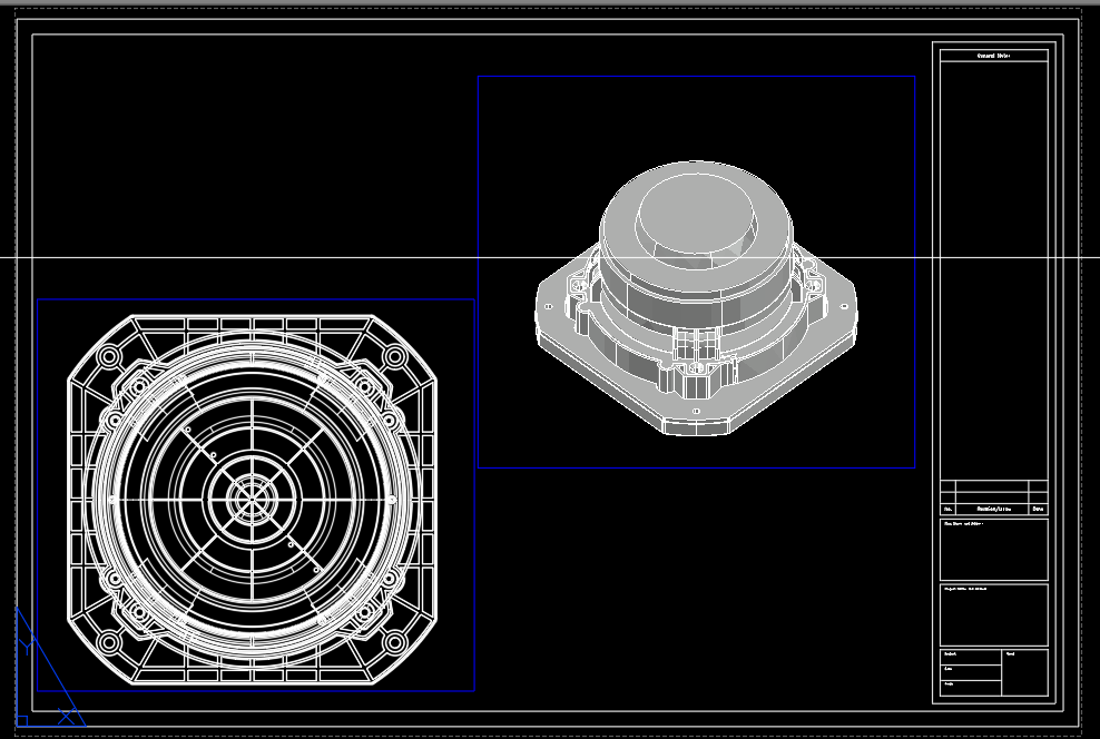

foxint Posted August 17, 2019 Author Share Posted August 17, 2019 hi Steven-g Thank you for your kind offer. I am a small town accountant and watchmaker, so CAD does not come easy to me. I have the full programme 2020. I was lucky enough to get the full step file from the Chinese Speaker Maker called Tang Band. What I did was convert it to dwg and the LHS is the full 3D and the middle and RHS are a rear cut showing what I was hoping would be the cut-out in the baffle board (front of speaker - with speaker fitting inside the box - I only need the cut-out for the front, but it is a little more complex than a circle and there is not much meat, if I put in a threaded insert....). I am hopeless at wood work and my tiny workshop is only suitable for watches - so this speaker is HUGE for me. The plan is to send a dxf or dwg file to a shop in Sydney (about 400km from here) and they can cut it for me. I need 1) the complete outside with screw holes and nothing in the middle - for a front facia piece and 2) the cut-out for the speaker that is essentially the first line moving inwards from the external. When I try and delete the parts the whole disappears. If you can help, or suggest a video on how, that would be great. I am hoping to one day (before I die - I am 60.. sh&^ I hate it when I say that...). So perhaps I am the typical Old Dog and this is a new trick....I like making things, but know my limitations. Thanks D TangBand-W5-2053.dwg Quote Link to comment Share on other sites More sharing options...

BIGAL Posted August 17, 2019 Share Posted August 17, 2019 You need to look into explode as its one object, and gradually you will turn it back into single elements using explode. Quote Link to comment Share on other sites More sharing options...
