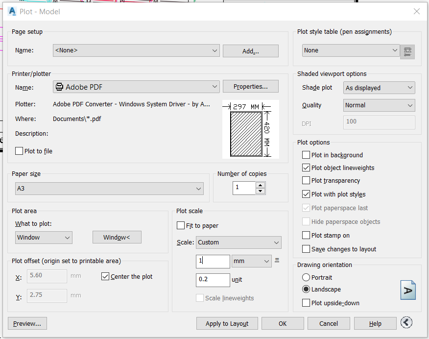

i know this software but i want lsp routine because software create PDF of round figure size and i have many type of paper size's

(command
	"_.-PLOT"
	"Y"									;Detailed plot configuration? [yes/no]
	Layout									;Enter Layout name or [?],layout1:
	"Dwg To PDF.pc3"							;Enter an output device name
	"ISO full bleed A3 (420.00 x 297.00 MM)"				;Enter paper size
	"M"									;Paper units: "M" for mm
	"L"									;Enter drawing orientation: "L" for Landscaping
	"N"									;Upside down? "N"
	"E"									;"E" for extents
	"1:2"									;Plot scale: Custom "1:2"
	"C"									;Counter "c"
	"Y"									;Plot Style? "y"
	"A3.ctb"								;Enter plot style: "A3.ctb"
	"Y"									;Plot line  weights?
	"N"									;plot line scaling?
	"N"									;Paper space first?
	"N"									;Hide?
	(strcat dwgpre "\\" pdfname "-" (getvar "ctab") ".pdf")			;Directory to save
	"N"									;save changes to page setup?
	"Y"									;proceed with plot?
Maybe this can help you!Good Luck!
