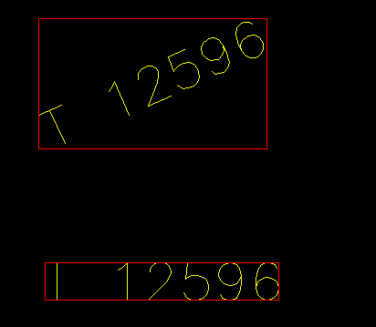

RepCad Posted August 10, 2019 Posted August 10, 2019 Hi all, I use Bounding box to create box around text but it doesn't create exactly around rotated text , my code : (setq s (car (entsel))) (setq obj (vlax-ename->vla-object s)) (vla-getboundingbox obj 'bl 'tr) (setq p1 (vlax-safearray->list bl)) (setq p2 (vlax-safearray->list tr)) (command "rectangle" p1 p2) Thanks in advanced. Quote
rlx Posted August 10, 2019 Posted August 10, 2019 (edited) minimal bounding box master Lee DBBox.lsp Edited August 10, 2019 by rlx 1 Quote
RepCad Posted August 10, 2019 Author Posted August 10, 2019 1 hour ago, rlx said: minimal bounding box master Lee Thanks, Can we also do it for dimension text?? (it means create bounding box around text of dimension) Quote
marko_ribar Posted August 10, 2019 Posted August 10, 2019 1 hour ago, amir0914 said: Thanks, Can we also do it for dimension text?? (it means create bounding box around text of dimension) You can set up that through dimension style dialog box, just experiment a little on your own... 1 Quote
RepCad Posted August 11, 2019 Author Posted August 11, 2019 (edited) On 8/10/2019 at 5:46 PM, marko_ribar said: You can set up that through dimension style dialog box, just experiment a little on your own... Thanks a lot. Edited August 30, 2019 by amir0914 Quote
