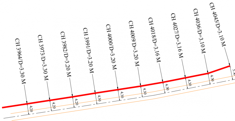

dlanorh Posted August 13, 2019 Share Posted August 13, 2019 6 hours ago, pmadhwal7 said: one problem found lsp was somewhere working and somewhere not. As mentioned above The lisp will flip any "unreadable" leader MText (i.e. text with a rotation angle >90 <270) through 180 to make it readable. If the MText has a rotation of 90 degrees or less, or 270 degrees or greater; it will be ignored. If you require something that flips all MText regardless of the current rotation angle let me know Quote Link to comment Share on other sites More sharing options...
pmadhwal7 Posted August 13, 2019 Author Share Posted August 13, 2019 (edited) 1 hour ago, dlanorh said: As mentioned above The lisp will flip any "unreadable" leader MText (i.e. text with a rotation angle >90 <270) through 180 to make it readable. If the MText has a rotation of 90 degrees or less, or 270 degrees or greater; it will be ignored. If you require something that flips all MText regardless of the current rotation angle let me know YES SIR I WANT.... ALSO IF POSSIBLE IT WILL AUTOMATICALLY CHANGE TEXT JUSTIFICATION LIKE UR CURRENT LSP DOING, AND ALSO WORK IN DTEXT TOO Edited August 13, 2019 by pmadhwal7 Quote Link to comment Share on other sites More sharing options...

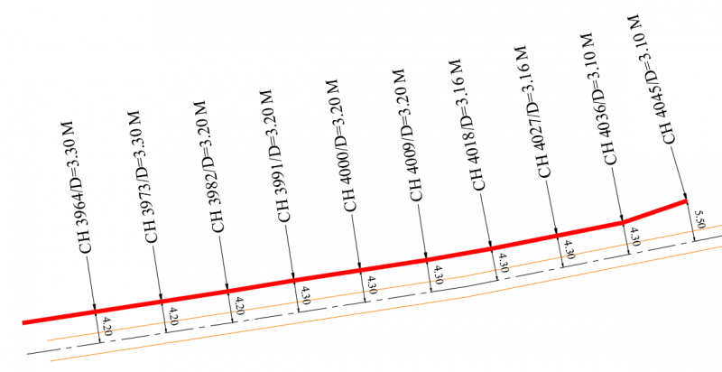

dlanorh Posted August 16, 2019 Share Posted August 16, 2019 Attached are two lisp flipmt - flips mtext flipt - flips text (it doesn't change the alignment point as there are no equivalent alignment points for 5 of the 14 different alignments) flipmt.lsp flipt.lsp 1 Quote Link to comment Share on other sites More sharing options...
