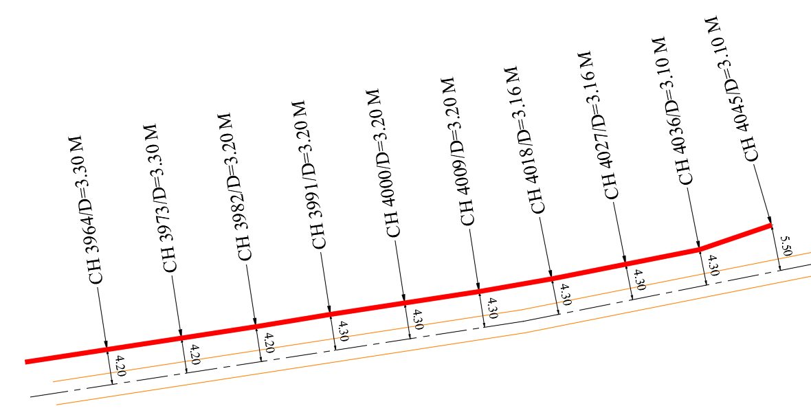

pmadhwal7 Posted August 10, 2019 Share Posted August 10, 2019 Looking for a lisp routine that will reverse many text mtext without moving its position, i have attached one lsp but reverse text/mtxt one by one but i want the lsp which work in bunch reverse.lsp sample.dwg Quote Link to comment Share on other sites More sharing options...
BIGAL Posted August 10, 2019 Share Posted August 10, 2019 Maybe this https://www.cad-notes.com/autocad-tip-rotate-multiple-texts-at-once-to-readable-orientation/ Quote Link to comment Share on other sites More sharing options...
pmadhwal7 Posted August 10, 2019 Author Share Posted August 10, 2019 18 minutes ago, BIGAL said: Maybe this https://www.cad-notes.com/autocad-tip-rotate-multiple-texts-at-once-to-readable-orientation/ yes sir this the good command can u modify my lsp like this? Quote Link to comment Share on other sites More sharing options...
dlanorh Posted August 10, 2019 Share Posted August 10, 2019 (edited) Try this quicky. Mtext only, Only selects items on unlocked layers (defun c:rmt ( / *error* sv_lst sv_vals c_doc a_lst ss obj rot a_num i_pt) (defun *error* ( msg ) (mapcar 'setvar sv_lst sv_vals) (if (and c_doc (= 8 (logand 8 (getvar 'UNDOCTL)))) (vla-endundomark c_doc)) (if (not (wcmatch (strcase msg) "*BREAK*,*CANCEL*,*EXIT*")) (princ (strcat "\nOops an Error : " msg " occurred."))) (princ) );_end_*error*_defun (setq sv_lst (list 'cmdecho 'osmode) sv_vals (mapcar 'getvar sv_lst) c_doc (vla-get-activedocument (vlax-get-acad-object)) a_lst (list 0 9 8 7 6 5 4 3 2 1) );end_setq (mapcar 'setvar sv_lst '(0 0)) (if (and c_doc (= 8 (logand 8 (getvar 'UNDOCTL)))) (vla-endundomark c_doc)) (vla-startundomark c_doc) (setq ss (ssget ":L" '((0 . "MTEXT")))) (cond (ss (repeat (setq cnt (sslength ss)) (setq obj (vlax-ename->vla-object (ssname ss (setq cnt (1- cnt)))) rot (vlax-get-property obj 'rotation) a_num (vlax-get-property obj 'attachmentpoint) i_pt (vlax-get-property obj 'insertionpoint) ) (cond ( (< (/ pi 2.0) rot (* (/ pi 2.0) 3)) (setq a_num (nth a_num a_lst) rot (+ pi rot) ) (mapcar '(lambda (x y) (vlax-put-property obj x y)) (list 'rotation 'attachmentpoint 'insertionpoint) (list rot a_num i_pt)) ) );end_cond );end_repeat ) );end_cond (if (and c_doc (= 8 (logand 8 (getvar 'UNDOCTL)))) (vla-endundomark c_doc)) (mapcar 'setvar sv_lst sv_vals) (princ) );end_defun Edited August 11, 2019 by dlanorh code correction Quote Link to comment Share on other sites More sharing options...

dlanorh Posted August 11, 2019 Share Posted August 11, 2019 In that case something similar will work on text, but not using this method as, depending on the alignment different points are used (insertion point or text alignment point. Also not every alignment has a complimentary. I'll post something in about an hour. Quote Link to comment Share on other sites More sharing options...
dlanorh Posted August 11, 2019 Share Posted August 11, 2019 This should work for "TEXT" items. Again only on unlocked layers (defun rh:gbbc (obj / ll ur lst c_pt) (if (and obj (= (type obj) 'ENAME)) (setq obj (vlax-ename->vla-object obj))) (cond (obj (vlax-invoke-method obj 'getboundingbox 'll 'ur) (setq lst (mapcar 'vlax-safearray->list (list ll ur)) c_pt (mapcar '(lambda (x y) (/ (+ x y) 2.0)) (car lst) (cadr lst)) );end_setq ) );end_cond c_pt );end_defun (vl-load-com) (defun c:rt ( / *error* sv_lst sv_vals c_doc ss cnt obj rot pt) (defun *error* ( msg ) (mapcar 'setvar sv_lst sv_vals) (if (and c_doc (= 8 (logand 8 (getvar 'UNDOCTL)))) (vla-endundomark c_doc)) (if (not (wcmatch (strcase msg) "*BREAK*,*CANCEL*,*EXIT*")) (princ (strcat "\nOops an Error : " msg " occurred."))) (princ) );_end_*error*_defun (setq sv_lst (list 'cmdecho 'osmode) sv_vals (mapcar 'getvar sv_lst) c_doc (vla-get-activedocument (vlax-get-acad-object)) );end_setq (mapcar 'setvar sv_lst '(0 0)) (if (and c_doc (= 8 (logand 8 (getvar 'UNDOCTL)))) (vla-endundomark c_doc)) (vla-startundomark c_doc) (setq ss (ssget ":L" '((0 . "TEXT")))) (cond (ss (repeat (setq cnt (sslength ss)) (setq obj (vlax-ename->vla-object ent) rot (vlax-get-property obj 'rotation) pt (rh:gbbc obj) );end_setq (cond ( (< (/ pi 2.0) rot (* (/ pi 2.0) 3)) (vlax-invoke obj 'rotate pt pi))) );end_repeat ) );end_cond (if (and c_doc (= 8 (logand 8 (getvar 'UNDOCTL)))) (vla-endundomark c_doc)) (mapcar 'setvar sv_lst sv_vals) (princ) );end_defun Quote Link to comment Share on other sites More sharing options...

dlanorh Posted August 12, 2019 Share Posted August 12, 2019 2 hours ago, pmadhwal7 said: sir command????? i was wrote rt but also asking for select object This is a different version to work with "TEXT", Not Leader "MTEXT" as in your attached drawing, and it was posted to @StevJ in response to a request from him. I have rechecked the lisp I attached in my post to you, and it still works with the drawing you posted. It is a stand alone lisp for Leader MText, as altering your lisp to work with a selection sets (multiple objects) would entail rewriting most of a large multi-purpose lisp file. The lisp will flip any "unreadable" leader MText (i.e. text with a rotation angle >90 <270) through 180 to make it readable. The command for the lisp I attached to you is "rmt" Quote Link to comment Share on other sites More sharing options...
