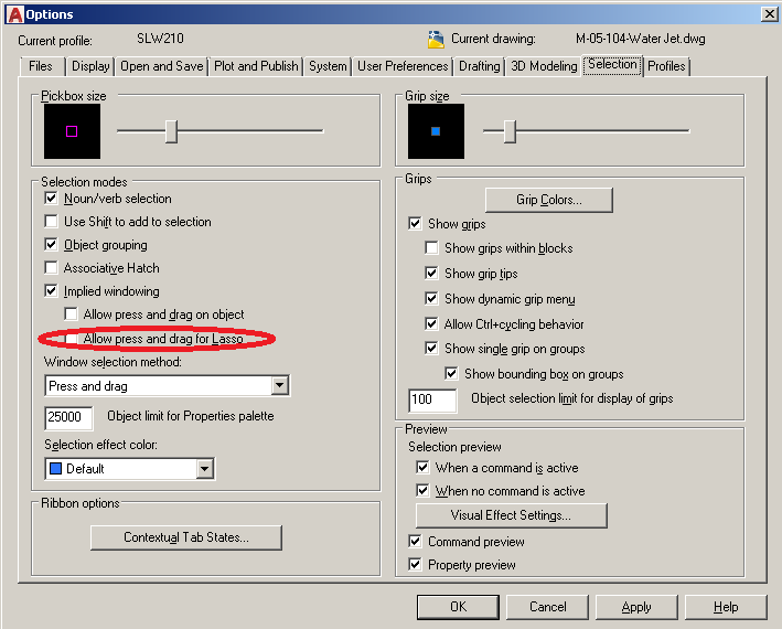

Help!  I've obviously changed a setting, and now my selection window is not in rectangular form but a strange arched-impossible-to-select-anything format.  I can't remember where to go to correct this.  Any help would be appreciated!  Joe
My guess is that you've changed the default behavior of your selection window. Go to your Options utility and open the Selection tab. Check the Selection Modes settings. If you don't know what these options are, I suggest you learn them. Make sure they reflect the way you like to work. Also make sure Selection Cycling is off and that your selection rectangle hasn't changed to a polygon or fence.
PICKAUTO system variable. I have mine set to 1. It is also in Options>Selection
Yes, Lasso Mode IS the culprit.  I think it was from a customers dwg that was set-up that way. Thanks for everyone’s input!
