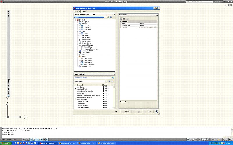

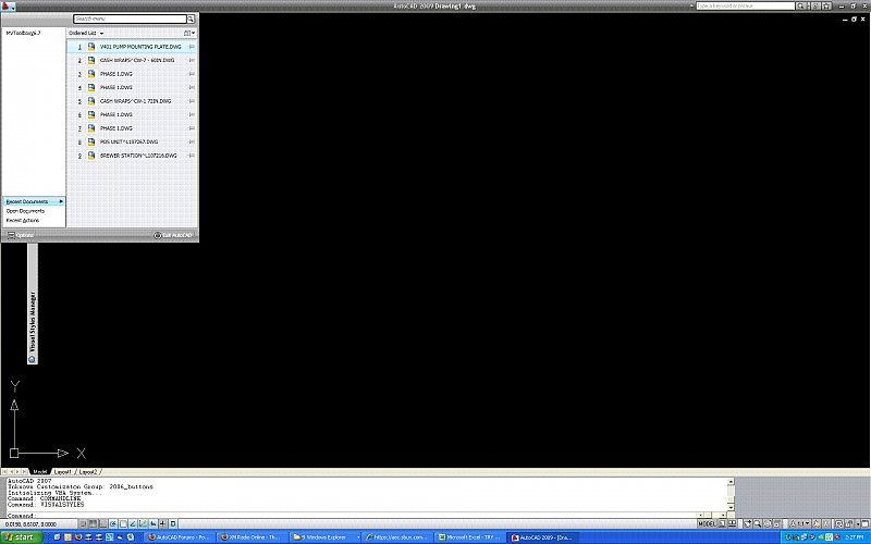

i tried to edit a macro in one of the commands. when i clicked apply. i got an out of memory error and now nothing loads into autocad. this is what the drop down menue looks like. as you see there is all the menue missing, and in the cui there is half of what is supposed to be in there
Type MENULOAD and see what CUI is loaded. Maybe while there try to reload the ACAD.cui and see if that helps.
when i type CUI and try to reload the audocad.cui it says it cannot load that file. i think it has become corrupt
Have you tried the repair from the install disk?
the reapir did nothing. all i did since i upgraded from 06 was use the migrate settings utility. and it recreated the cui's. everything is all good now.
