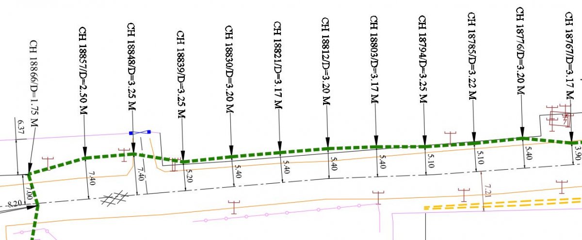

pmadhwal7 Posted August 3, 2019 Posted August 3, 2019 need a lisp to put align dimension refer attachment Quote

pmadhwal7 Posted August 10, 2019 Author Posted August 10, 2019 1 hour ago, BIGAL said: Thanks myloveflyer. The automated version of this would do say all vertice points or at fixed chainages. Again peg and shift report. fixed points like i attached the image Quote

BIGAL Posted August 10, 2019 Posted August 10, 2019 You can use VL getclosestpointto so just pick all he Leaders ? get end point and compare to road pline. Just need to confirm it is a "leader" ? What layer for dims and style name. Quote
pmadhwal7 Posted August 10, 2019 Author Posted August 10, 2019 17 minutes ago, BIGAL said: You can use VL getclosestpointto so just pick all he Leaders ? get end point and compare to road pline. Just need to confirm it is a "leader" ? What layer for dims and style name. yes sir it's leader Quote
BIGAL Posted August 10, 2019 Posted August 10, 2019 Have a look at this no error checking and you need to set current dimstyle ; peg shift routine ; By AlanH Consulting Aug 2019 (alert "pick leaders when asked for selection") (defun c:pegshift ( / ss obj obj2 obj3 co-ords pt1 pt2) (setq ss (ssget (list (cons 0 "leader")))) (setq obj (vlax-ename->vla-object (car (entsel "Pick pline")))) (repeat (setq x (sslength ss)) (setq obj2 (vlax-ename->vla-object (ssname ss (setq x (- x 1))))) (setq co-ords (vlax-safearray->list (vlax-variant-value (vlax-get-property obj2 "Coordinates" ) ) ) ) (setq pt1 (list (nth 0 co-ords)(nth 1 co-ords))) (setq pt2 (vlax-curve-getclosestpointto obj pt1)) (command "dim" "_al" pt1 pt2 pt1 "" "exit") (setq obj3 (vlax-ename->vla-object (entlast))) (vla-put-ExtLine2Suppress obj3 -1) (vla-put-ExtLine1Suppress obj3 -1) ) ) (c:pegshift) Quote
pmadhwal7 Posted August 10, 2019 Author Posted August 10, 2019 1 hour ago, BIGAL said: Have a look at this no error checking and you need to set current dimstyle ; peg shift routine ; By AlanH Consulting Aug 2019 (alert "pick leaders when asked for selection") (defun c:pegshift ( / ss obj obj2 obj3 co-ords pt1 pt2) (setq ss (ssget (list (cons 0 "leader")))) (setq obj (vlax-ename->vla-object (car (entsel "Pick pline")))) (repeat (setq x (sslength ss)) (setq obj2 (vlax-ename->vla-object (ssname ss (setq x (- x 1))))) (setq co-ords (vlax-safearray->list (vlax-variant-value (vlax-get-property obj2 "Coordinates" ) ) ) ) (setq pt1 (list (nth 0 co-ords)(nth 1 co-ords))) (setq pt2 (vlax-curve-getclosestpointto obj pt1)) (command "dim" "_al" pt1 pt2 pt1 "" "exit") (setq obj3 (vlax-ename->vla-object (entlast))) (vla-put-ExtLine2Suppress obj3 -1) (vla-put-ExtLine1Suppress obj3 -1) ) ) (c:pegshift) it was asking for select object when i am going to select polyline it was showing 0 object selected.... Quote
Tharwat Posted August 10, 2019 Posted August 10, 2019 (edited) Hi, What is the type of the object in the attached image? Dimension or Leader or Mleader? Can you upload sample drawing? Edited August 10, 2019 by Tharwat Quote
BIGAL Posted August 10, 2019 Posted August 10, 2019 The leaders are picked by the selection just window/pick which ones, you need then to pick the road alignment pline. You must set correct dimstyle to use as well. change (entsel "Pick pline") To (entsel "Pick road pline") Quote
