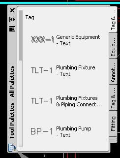

Tag plumbing fixtures
don't know how to put plumbing fixture text on any one know how?
i get this
Selected entity must be of type: Multi-View Part

That's it . I've also seemed to have lost the lav section in my tool palettes do you know how i can get it back?
Try to right click the icon at the bottom left corner of the tool palette and select customize palettes. You should be able to drag what you want from the left to the right. Just make sure you are putting it on the right palette.

but now i don't have this
