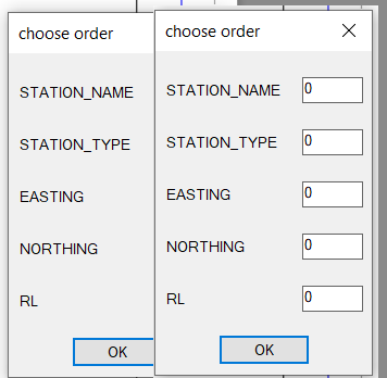

ronjonp the multi attribute is about the problem I mentioned in another post using attribute order is easier and can have different number of attributes in each block, need to build the dcl selection form 2 lists maybe with tag names filled in 2nd list allows up down of order. I think lee has something. something like this but 1 dcl and  better.
