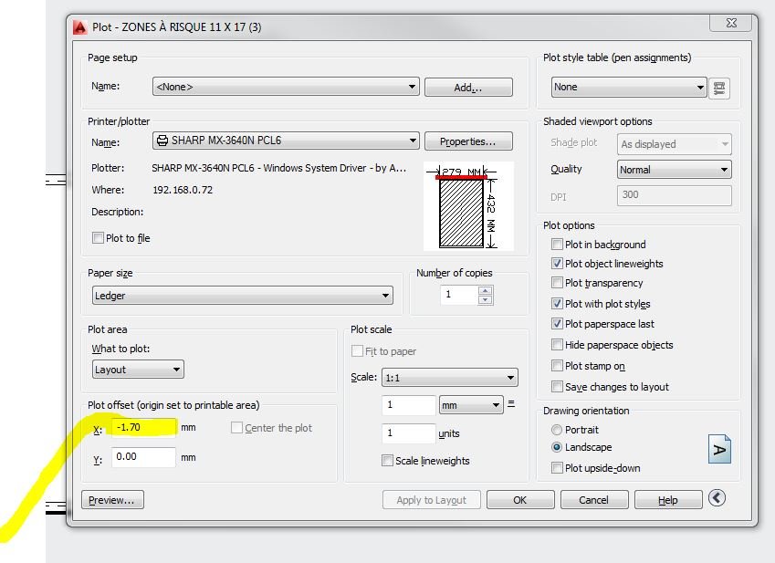

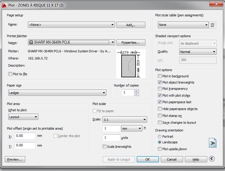

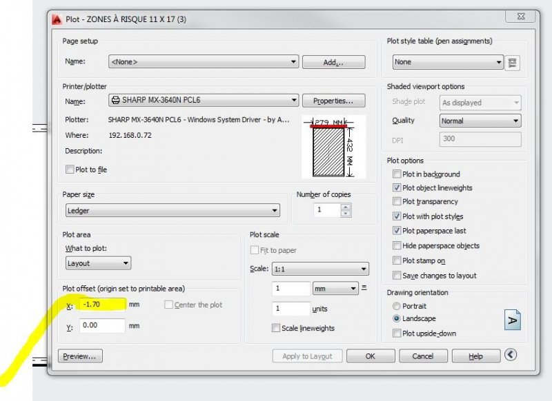

maratovich Posted July 22, 2019 Share Posted July 22, 2019 Show us a picture of your print settings. Quote Link to comment Share on other sites More sharing options...
NoroZorro Posted July 22, 2019 Author Share Posted July 22, 2019 Quote Link to comment Share on other sites More sharing options...

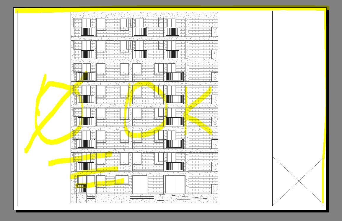

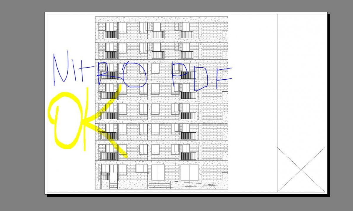

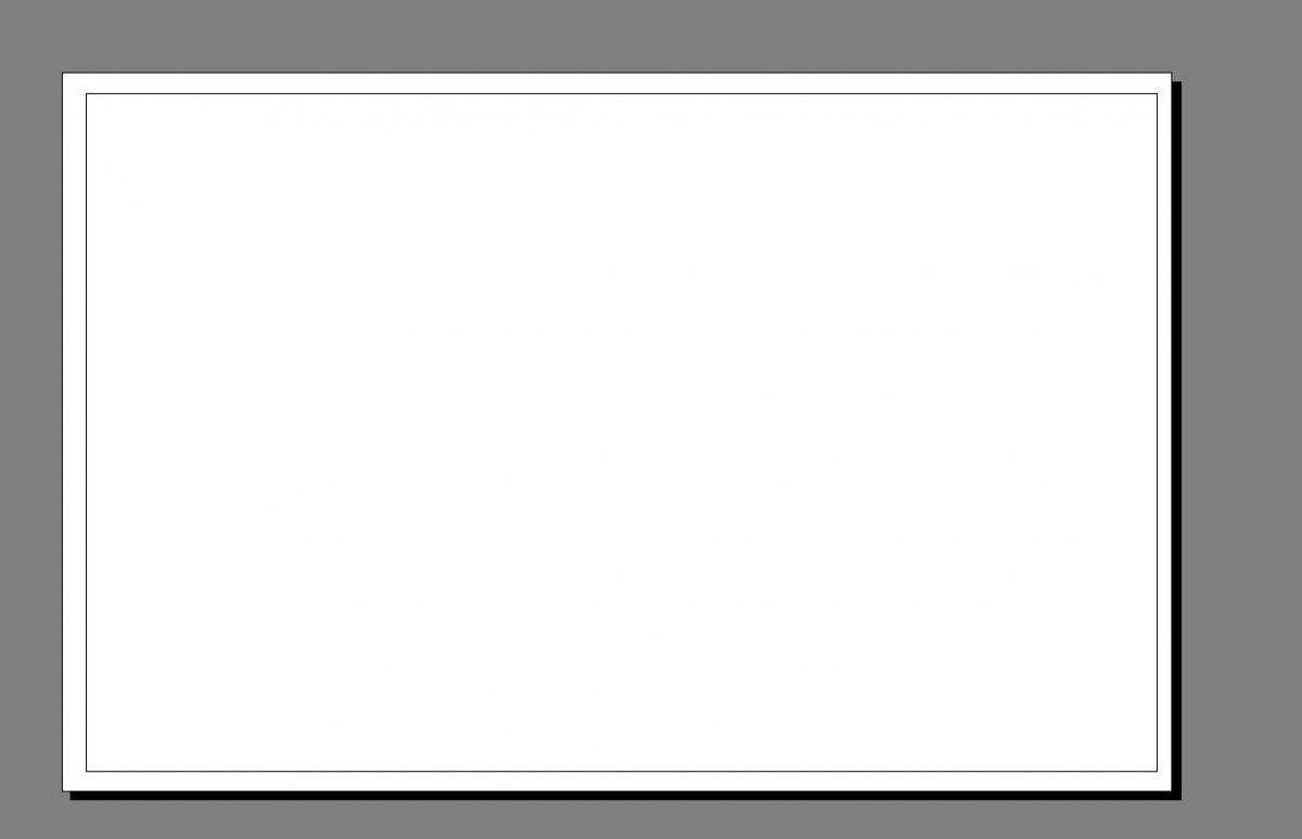

NoroZorro Posted July 23, 2019 Author Share Posted July 23, 2019 (edited) Quote Do the boundaries of your work tend to shift over time? Testing on a different file, than my screenshots of printer setup If I understand the term boundaries, I would say, that my boundary is rectangle inside the dash line(the plotting area) Viewport locked or unlocked, the drawing with nitro pdf comes our right. If I indicate the real printer, than my boundaries shift Quote Then for me use a lisp and it plots every time with limited user input I've autocat lt, lisps are not avaible in this edition Edited July 23, 2019 by NoroZorro Quote Link to comment Share on other sites More sharing options...
CyberAngel Posted July 23, 2019 Share Posted July 23, 2019 Every plotter has margins that it can't print outside of. Those are physical limits so that, for instance, a print head won't catch the edge of the paper and tear it. It looks like your viewport is set up for the full paper size. If you use Page Setup Manager, you can experiment with what you see on the screen versus what you get in a plot. Typically there is a shaded area in paper space around the paper size, with a dotted border around the effective plot size. There is a "bleed through" option on some plotters that will give you a bit more space. Quote Link to comment Share on other sites More sharing options...
RobDraw Posted July 23, 2019 Share Posted July 23, 2019 There is no need to recreate the window every time. If a window plot gets you the correct results, all you need to do is apply the print settings to the layout in order to save the window. Even better, create a named page set-up that can be recalled at printing time. This named page set-up can them be imported into any file needing the same plot settings. Quote Link to comment Share on other sites More sharing options...
