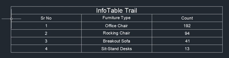

But the issue I am facing is that even after changing the value of cell margins,the width of the table cells are very large.
Can somebody suggest how to solve this issue ? (currently I have to manually adjust the width each time)
I want the width of the column slightly wider than the contents.
Thanks
The width of the columns of an AutoCAD table is a property of the table object itself, not of the table style. Programmatically, this is dictated by the value of the column width parameter supplied to the AddTable method when creating the table object.
If you require the table to have columns of unequal width, you can change the width of each column independently using the SetColumnWidth method of the table object. You may wish to review the code for my LM:AddTable function as used in my Polyline Information program for an example.
