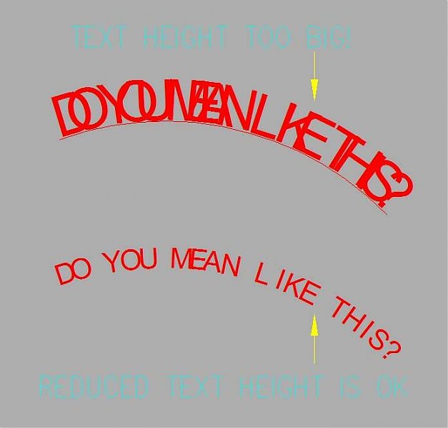

The text will overlap if the Text height is to big for the Arc see image:
Not very clear sorry.......... click on the text & change in properties.
All editing can be done in the properties. You can change the radius, or start and end angles or arc offset to affect the length of the arc. Or you can change the text height and width factor to change the text itself.
The text has to stay the same size to meet drafting standards however the size is not the issue. The arc is 550 feet long, the text only takes up 250 of that.
Ok, that works with some modifying. I just wish you could edit the character spacing after placing the text. It's better than what I had before though. I appreciate the help. Thanks guys!!
