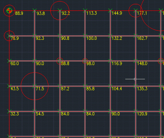

D'Jewel Posted July 19, 2019 Posted July 19, 2019 Good Afternoon, Everyone. I'm working on the Civil Drafting Project and I don't understand how to interpolate where the contour intervals cross the gridlines. I have drawn my grid with all of the values included, but I'm not understanding how to calculate the values. Could someone please assist me. I'm at a standstill. I would really appreciate it and be forever thankful! Quote

ReMark Posted July 20, 2019 Posted July 20, 2019 Perhaps this explanation might help. Figure out the difference in elevation between the lowest and highest spot elevation. Divide this by the distance between the two spot elevations. This will give you the percentage of slope. Calculate the difference in elevation between the new spot elevation you wish to plot and the lowest spot elevation. Divide this by the percent slope previously calculated. This will result in the distance from the lowest elevation to your new spot elevation. Quote
ReMark Posted July 20, 2019 Posted July 20, 2019 Let's try this example. You have two spot elevations. We'll call them the high spot and the low spot. The high spot = 54.0 and the low spot = 32.7. What is the difference in elevation between the two? Subtract the low spot of 32.7 from the high spot of 54.0 which equals 21.3. What is the distance between the high spot and the low spot? On our drawing we can either measure it using the Distance command or read it directly if the spot elevations are plotted on our grid which uses a square pattern of 50x50. Just for the sake of argument lets say the spot elevations fall on the grid and our distance then equals 50. Divide the difference in elevation (21.3) by the distance (50) and what do you get? The answer is 0.426 which is the percent of grade. With me so far? I hope so. Now let's say we want to know, and plot, the 40 foot contour. 40 minus 32.7 (our low spot) = 7.3. Divide 7.3 by the percent of grade of 0.426 and what do you get? The answer is 17.136 which we can round off to 17.14. This is the distance FROM the low spot you have to measure out. Draw a circle with a radius of 17.14 using as your basepoint the location (on the grid) of your low spot as it's center. Where the circle crosses the grid between the low and high spot elevations is where your 40 foot contour will be located. Place some sort of line or block or whatever you want to use at this point (preferably something you can 'snap' to later on). That's it basically in a nutshell. Personally I like to always work from the lowest elevation towards the highest elevation although it can be done the opposite way. No matter which way you use the new elevation (40) should be located in the same spot between the two known elevations you started with. Now, it's your turn. Go. Do. Now. Quote

D'Jewel Posted July 20, 2019 Author Posted July 20, 2019 Also, if the spot elevations are something like 113.3 and 144.9, what contour do I use: 130 perhaps? Or, are you using the contour closest to the low spot? I guess that would make more sense. This still leaves the question about numbers within the same contour, such as 93.8 and 92.2. I have attached a screenshot of what I already have done. I'm going to remove the circles when I finish. I have used the instructions you gave me above and it makes it so much easier to complete. Please forgive my questions. I know very little about Civil Drafting (only what the course explains, which did not include much about calculating the contour intervals in this project, I'm afraid). Quote
ReMark Posted July 20, 2019 Posted July 20, 2019 On 7/20/2019 at 3:35 PM, D'Jewel said: Another quick question: how does it work when the spot elevations are both within 10? Meaning I have two spot elevations that are 93.8 and 92.2. In the example you gave, there is a 40 foot contour that is between the two numbers 54.0 and 32.7. Between 93.8 and 92.2 there is no rounded contour. How is that calculated? I hope that makes sense. Expand I beg to differ with you. The contour between 93.8 and 92.2 is 93.0. The project uses one foot contour intervals. Quote
ReMark Posted July 20, 2019 Posted July 20, 2019 On 7/20/2019 at 3:44 PM, D'Jewel said: Also, if the spot elevations are something like 113.3 and 144.9, what contour do I use: 130 perhaps? i have used the instructions you gave me above and it makes it so much easier to complete. Please forgive my questions. I know very little about Civil Drafting (only what the course explains, which did not include much about calculating the contour intervals in this project, I'm afraid). Expand Contour levels that fall between 113.3 and 144.9 would start with 114 then proceed in one foot intervals all the way up to 144. If the contour level is 5 then the contour levels would start with 115 and proceed in five foot intervals all the way up to 140. And if the contour level was 10 then the contour levels would start with 120 then proceed to 130 and finally 140. The course instructions denote which contour level should be used. Quote
D'Jewel Posted July 20, 2019 Author Posted July 20, 2019 I understand for the most part. I went back and looked again at the directions, and it says that the "company will conduct this survey at 10-foot contour intervals". Thank you for that info. That being said, could I use 1-foot intervals for the numbers like 93.8 and 92.2, since both fall within the 10-foot interval, or would that mess up the project? Again, thanks for everything. The information you've already given me has helped me past a stopping point. I've been working on it ever since I received your advice. I've done all of the ones that follow the example you gave me earlier. I don't mean to be special, I just want to understand. Quote
ReMark Posted July 20, 2019 Posted July 20, 2019 There is no 10 foot interval between 93.8 and 92.2 therefore there would be no contour. Leave it alone. Sorry I mislead you regarding the contour interval (10 foot not 1 foot). Good work. Quote
