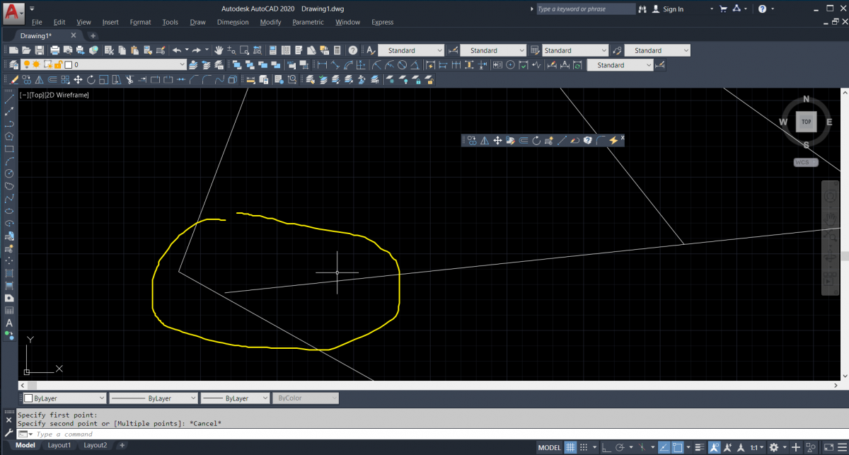

rock1 Posted July 18, 2019 Share Posted July 18, 2019 Is there a separate gap detection command in autocad that highlights tiny gaps of closed polygons? I render my drawings in photoshop and often there are small gaps that appear in my work or the work that I get from others. Right now only hpgaptol and using hatch command highlights the small gaps. Quote Link to comment Share on other sites More sharing options...
CyberAngel Posted July 18, 2019 Share Posted July 18, 2019 Here's a LISP routine to mark gaps: GAP Here's an Autodesk discussion on the topic. Both found by googling "autocad gap detection." 1 Quote Link to comment Share on other sites More sharing options...
rock1 Posted July 18, 2019 Author Share Posted July 18, 2019 I just tried on the following drawing. I set the gap limit to 0.5. The gap is almost 0.2 but still goes undetected. I'm using Autocad 2020. TEST DRAWING_THURS.dwg Quote Link to comment Share on other sites More sharing options...
CyberAngel Posted July 19, 2019 Share Posted July 19, 2019 My first guess was that, once the routine found a match, it went on to another point. But after looking at the code, I believe it takes care of that potential oversight. I opened your drawing. Maybe it's my units setting, but when I measure that gap, it's 1.66. That's outside the tolerance, so it wouldn't be flagged. Quote Link to comment Share on other sites More sharing options...
