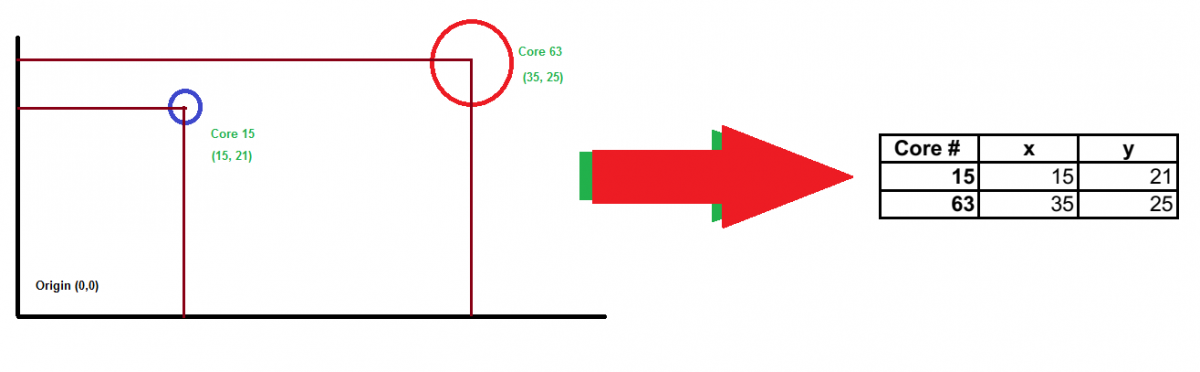

Hello Everyone, Happy to be part of this CAD forum. I need your help with the following problem.
I have a drawing having circles at various locations (almost 120 circles) each representing a coring location. I need to make a table in the same drawing showing the number of that circle as well as its x,y coordinates with reference from a specific origin to be chosen (not the CAD drawing origin).
Any help is appreciated as i am new to Visual LISP (Done programming in other languages but not in a LIST processing language).
Thanks.
How can we know the core# ?  Is that a text next to the circle?
Actually core number should also be added by LISP. Even if there is existing core number I don't mind it as I need offsets for circular portion only.
I found one code which helps me to find out the x and y from a reference of 0,0 origin. My next problem is to find out size of each circle (by some modification or data extraction from code below) as well as sequentially number the cores (or circles).

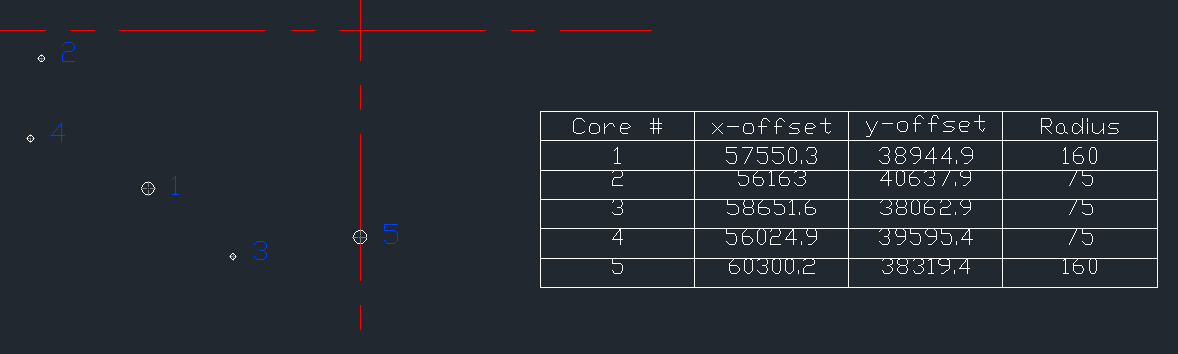

Excellent. Many thanks Mr. Emmanuel.
Just one last request. I also need to add one column to table showing the SIZE of each core. I have only two size i.e. 75mm and 150mm cores. So it will be really helpful if 2nd column is for size in mm and then x and y as usual.
It would help to know if the core sizes are diameters or radii
I added the Radius .
If you want the diameter, then change
(rtos radi 2 2)
to
(rtos (* radi 2.0) 2 2)
If you want the volume:
(rtos (* pi (* radi radi)) 2 2)
And thange the title (list "Core#" "x" "y" "Radius")  ;; head

Many Thanks. Just sharing my final image so that it can a good reference for somebody looking for similar problem. In the meanwhile I am trying to get better grasp of VLisp as I have background in Java, C++, Python and VBA (very different from list programming).

;; Offset for each Circle Center
(defun c:occ ( / lst startnumber ss ss_sorted bp pt i ip radi)
  ;; select circles
  (princ "\nSelect circles then press enter: ")
  (setq ss (ssget (list (cons 8 "Cores") (cons 0 "CIRCLE"))))
  (setq ss (sort_ss_by_xy ss "x"))
  (setq bp (getpoint "\nBase point for offset: "))
  (setq pt (getpoint "\nInsert point of the table: "))
  (setq startnumber (getint "\nStart Number: "))
  ;; make the list
  (setq lst (list
  (setq i 0)
  (repeat (sslength ss)
    (setq ip (cdr (assoc 10 (entget (ssname ss i)))))    ;; circle center
    (setq radi (cdr (assoc 40 (entget (ssname ss i)))))  ;; circle radius (so we know where to put the label)
    ;; append the list
    (setq lst (append lst (list
      (list
        (+ i startnumber )  ;; counter, starting with user set start number
        (rtos (car ip) 2 2)  ;; 2 decimals, feel free to change this
        (rtos (cadr ip) 2 2)
        (rtos radi 2 2)
    (Text
      (list (+ (nth 0 ip) (* 2. radi)) (- (nth 1 ip) radi) )
      300
      (itoa (+ i startnumber))
      200  ;; purple
    (setq i (+ i 1))
  (inserttable lst pt)
Edited by Emmanuel Delay
  • Thanks 1
Wow you're the hero Mr. Emmanuel. Super thanks for all your efforts and help. Now I got full set of tools to deal with messy corings and got complete control over them.
BTW I also bought the book "AutoCAD Developers Guide to Visual LISP" in order make myself more familiarized with AutoLISP and also to develop my own programs.
Thanks a lot. 🌻
