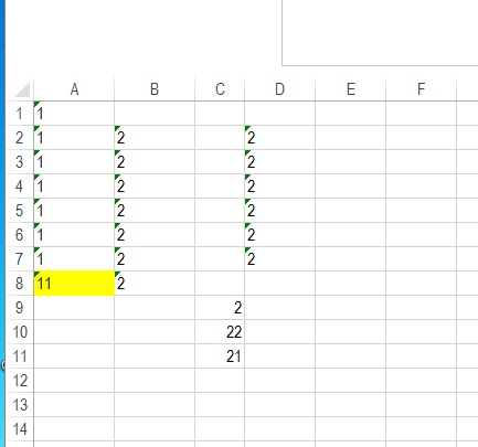

How to know the latest cell number
Only in the column  A
As it is shown in the picture
Where it is in the language VBA EXCEL
The variable ( LD )  gives another cell number containing data in the column A
Dim LD As Long
LD = Range("A" & Rows.Count).End(xlUp).Row
You can help with this idea in  fixo LISP
THANK YOU

Praise be to God
 I found the solution
(setq SelRng (vlax-get-property Sht 'Range "A1000"));CELL A1000
(vlax-invoke-method SelRng "Select")
(setq NextRng (vlax-get-property ExcelApp "Selection"));SELECT_RANGE
(setq DesRng (vl-catch-all-apply'vlax-get-property (list NextRng "End" -4162))); -4121 = xlUp ;GO TO UP CELLS
(SETQ lastCellE (vlax-invoke-method DesRng "Select")); SELECT
COUNT ROWS IN RANG LAST CELL TO A1
  (setq RangROW (vlax-get-property Sht "Range" DesRng (strcat "A" (itoa 1))));get RANG LAST CELL+A1
(vlax-invoke-method RangROW "Select")
(setq RowNum0 (vlax-get-property(vlax-get-property RangROW "Rows") "Count"));COUNT ROWS IN RANG LAST CELL TO A1
  • Thanks 1
