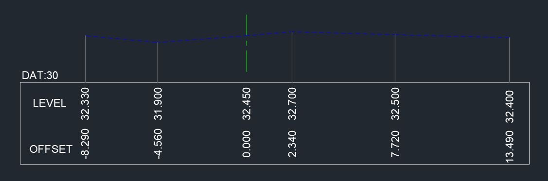

Ish Posted August 19, 2019 Posted August 19, 2019 On 8/19/2019 at 8:31 AM, pmadhwal7 said: may this lsp will help you Expand thanks but this for long section, i am looking cross section offset value for left & right see attach image Quote

Ish Posted August 19, 2019 Posted August 19, 2019 On 8/19/2019 at 11:56 AM, pmadhwal7 said: first it was asking horizontal scale then vertical scale then chainage then datum then pick 3d line and place anywhere you want Expand according this process only draw long profile. Sir, Command: LS Enter horizental scale :1000 Enter vertical scale :1000 Enter starting chainage :0 Enter datum value :41 Select 3Dpoly line : Specify starting point : see attach image Quote
Ish Posted August 19, 2019 Posted August 19, 2019 On 8/19/2019 at 1:05 PM, Ish said: Enter starting chainage :0 Expand i got your point sir. here Enter starting chainage :0 (this value must be type calculate one total distance from center line (in negative format like -28.583) *take aligned dim vertex to vertex then make total distance and type at Enter starting chainage. -28.583 Thanks Quote

Guest Posted September 21, 2021 Posted September 21, 2021 Hi Ish. I know that the post is old but i try this code and draw the section but not fill the text .Givew me only 0 nad 90 in the text !!! Not like the image you post Thanks Quote
Saqib_theleo Posted September 21, 2021 Posted September 21, 2021 On 9/21/2021 at 9:05 AM, prodromosm said: Hi Ish. I know that the post is old but i try this code and draw the section but not fill the text .Givew me only 0 nad 90 in the text !!! Not like the image you post Thanks Expand try to change current text style height to 0. Quote
