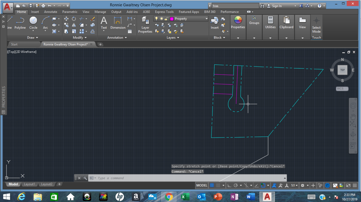

I am in need of guidance on how to draw the lots 1,2,3,4 and 5.  I have been able to get up to this point with the directions people have provided here which has been very helpful.   I looked at the other post but it still does not make sense to me. Thank you.
Edited by Megan
Megan: The instructions on how to create the property lines for lots 1 thru 3 are outlined in the link I provided previously.  I used the OFFSET command.  Starting with the northern boundary line offset this line downwards a distance of 60.  Then offset the newly created line, again downwards, another distance of 60, and finally offset that newly created line, downwards, one more time, a distance of 60.  Next, using the same command, offset the western boundary line, to the right, a distance of 120.  Look at the 2nd page of the previously mentioned thread, second post from the top, and you'll see what the result should look like.  Using the newly created line that runs parallel to the western boundary TRIM the three lines that run parallel to the north boundary line.  Do not trim the north boundary line itself.

I was able to make lots 1-3.  However when I looked at the picture you ad in the other posts you have extra streets I do not and I do not understand how to get the other lots.  Seriously have been sitting at my computer for the last 5 hours reading, youtube, and trying to understand so I can get this done.
I would appreciate more help.
The "extra streets" as you refer to them run adjacent to the top, right and bottom of the subdivision.  They are created by using the OFFSET command.  The distance to offset is spelled out in your instructions.  As for the creation of SW Village Lane I once again refer you back to the link previously posted.  Look at the 12th post on the second page.  This will get you started on creating the centerline for SW Village Lane.  Work on those items first then you can return to the creation of lots 4, 5 and 6.
