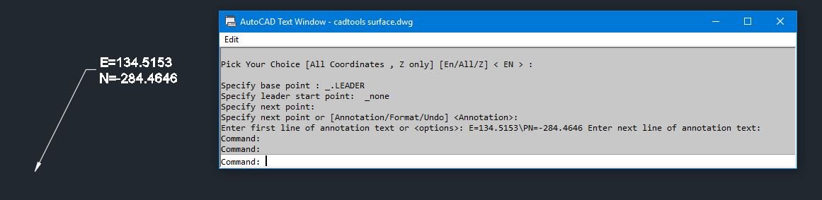

 now working good, by click.
please do small modify , every time i get coordinate , i must hit enter or click.,
if i need EN value only, until i press escape button that must give value .
i get EN  value than again hit enter for another EN value.
if any option select, i need continuously value by pick until i  press escape button.
See image, after get EN value it stop, for second En value i need hit enter.
thanks
Edited by Ish
MODIFY COMMENTS

Once you select an option this will continuously allow you to keep picking points until you hit Enter or Spacebar.

                 ("NoZ")
    (setq pnt (getpoint "\nSpecify base point : "))
    (while pnt
	  (setq dim (getvar 'DIMZIN))
	  (setvar 'DIMZIN 0)
	  (mapcar 'set
			  '(a b c)
			  (mapcar '(lambda (k p) (strcat k (rtos p 2 4)))
					  '("E=" "N=" "Z=")
					  pnt
	  (setvar 'DIMZIN dim)
	  (command "_.LEADER"
			   "_none"
			   pnt
			   (nth (vl-position key '("NoZ" "All" "Z"))
					(list (strcat a "\\P" b) (strcat a "\\P" b "\\P" c) c)
    ) ; while
 wonderful Sir,
now working perfectly.
Request To You just add code for layer,  create Layer Automatic And All value must come in Layer
layer Name "Coor Text"
Thanks a Lot.
