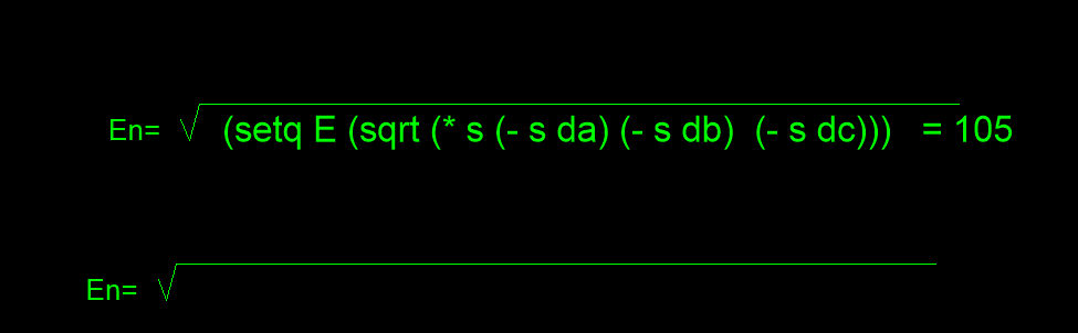

Is it possible to use a part of this export as block and insert the results in it. Then export all blocks with the total area like the heron export.dwg ?
thanks
Its your turn I turned it into a block and as I have already said just make the correct text and insert the block with 1 attribute, you have 676 posts its time to start doing it yourself.
You are right Bigal. I try this can you help me

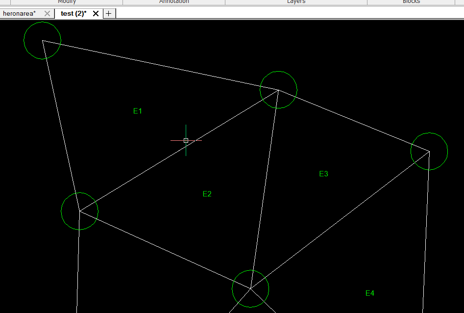

Just did it the quick way. You need to check areas. to make sure is correct, tested on your DWG you need the block I made its in your test dwg.
If you have like this image there is a simple way around it by using layiso.

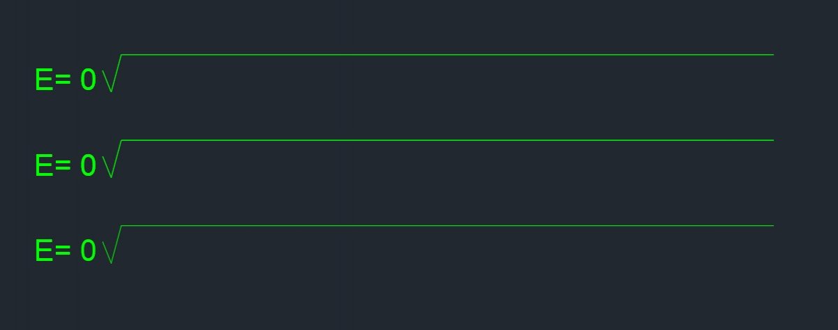

Hi BIGAL . I can not understand how this code works.
1)I select one text example E1
2)then i select all the polylines , but the insert block is empty.
3)Why the heron form is not in en extra dwg file ?
I tested in Briscad and it may honour the -insert 2020 does not so I added attdia it works now. Code updated.
Edited by BIGAL

I know that the post is old. I use this code to calculater the area with heron type.
Is any way this part of the text when i paste it in Autocad to be overline??
