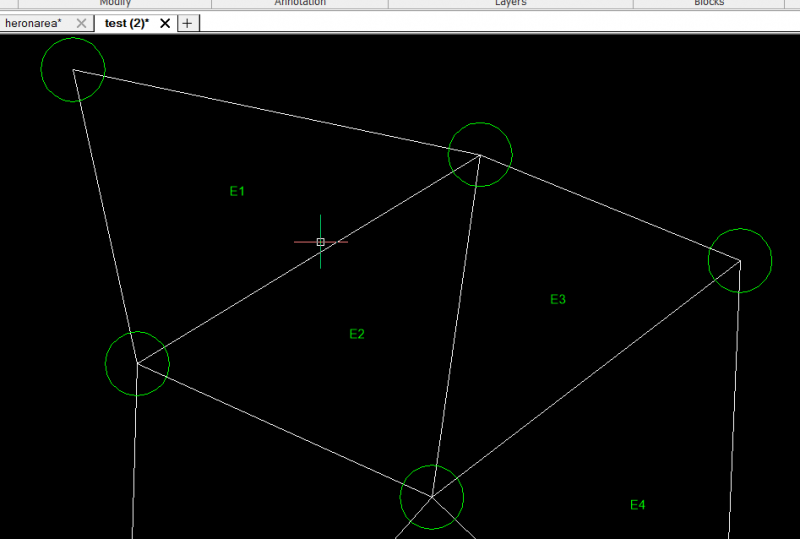

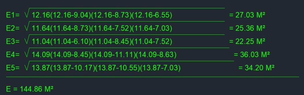

Guest Posted July 5, 2019 Posted July 5, 2019 is not a school project . I used an old program to do this calculations but is not working in windows 10. This program working through autocad. 1) select the triangles 2) Automatic add names E1,E2,E3,.............................En 3)Then insert the text with analytic calculation of the areas and the total area with Heron ' s Formula. We use in topography Heron ' s formula to calculate areas when we draw with triangles. Can any one help ? Thanks Quote

Guest Posted July 5, 2019 Posted July 5, 2019 hI steven-g . The test.dwg is a exactly what i need. Thanks test.dwgFetching info... Quote
rlx Posted July 5, 2019 Posted July 5, 2019 untested and almost lunchtime... (defun c:heron ( / tri-no p1 p2 p3 da db dc s E cp lst cnt fn fp Etotal) (setq tri-no 0 Etotal 0) (while (and (setq p1 (getpoint "\nP1 : "))(setq p2 (getpoint "\nP2 : "))(setq p3 (getpoint "\nP3 : ")) (setq da (distance p2 p3)) (setq db (distance p3 p1)) (setq dc (distance p1 p2)) (setq s (/ (+ da db dc) 2.0) ) (setq E (sqrt (* s (- s da) (- s db) (- s dc))))) ; while valid points are given (if (assoc (setq cp (tricent p1 p2 p3)) lst) (prompt "\nPoint allready entered") (progn (setq lst (append lst (list (cons cp (list (setq tri-no (1+ tri-no)) s da db dc E ))))) (entmakex (list '(0 . "TEXT") (cons 10 cp) (cons 40 0.25) (cons 1 (strcat "E" (itoa tri-no))))) ) ) ) (if (and (vl-consp lst) (setq fn (vl-filename-mktemp ".txt"))(setq fp (open fn "w"))) (progn (foreach x lst (setq x (cdr x) tri-no (nth 0 x) s (nth 1 x) da (nth 2 x) db (nth 3 x) dc (nth 4 x) E (last x)) (write-line (strcat "E" (vl-princ-to-string tri-no) " = V" (chr 175) " " (vl-princ-to-string s) " (" (vl-princ-to-string s) "-" (vl-princ-to-string da) ")(" (vl-princ-to-string s) "-" (vl-princ-to-string db) ")(" (vl-princ-to-string s) "-" (vl-princ-to-string dc) ") = " (rtos E 2 2) " m" (chr 178)) fp) (setq Etotal (+ Etotal E)) ) (write-line (strcat "E = " (vl-princ-to-string Etotal) " m" (chr 178)) fp) (close fp) ) ) (startapp "notepad" fn) (princ) ) gr.Rlx Quote
Guest Posted July 5, 2019 Posted July 5, 2019 Hi rlx. I have this error Quote Command: HERON P1 : P2 : P3 : ; error: no function definition: TRICENT Expand Thanks Quote
rlx Posted July 5, 2019 Posted July 5, 2019 oops (defun tricent (pt1 pt2 pt3)(mapcar '(lambda (x y z) (/ (+ x y z) 3)) pt1 pt2 pt3)) Quote
Guest Posted July 5, 2019 Posted July 5, 2019 Quote P1 : P2 : P3 : P1 : ; error: no function definition: WRITE-LINEΟ»Ώ Expand (defun c:heron ( / tri-no p1 p2 p3 da db dc s E cp lst cnt fn fp Etotal) (defun tricent (pt1 pt2 pt3)(mapcar '(lambda (x y z) (/ (+ x y z) 3)) pt1 pt2 pt3)) (setq tri-no 0 Etotal 0) (while (and (setq p1 (getpoint "\nP1 : "))(setq p2 (getpoint "\nP2 : "))(setq p3 (getpoint "\nP3 : ")) (setq da (distance p2 p3)) (setq db (distance p3 p1)) (setq dc (distance p1 p2)) (setq s (/ (+ da db dc) 2.0) ) (setq E (sqrt (* s (- s da) (- s db) (- s dc))))) ; while valid points are given (if (assoc (setq cp (tricent p1 p2 p3)) lst) (prompt "\nPoint allready entered") (progn (setq lst (append lst (list (cons cp (list (setq tri-no (1+ tri-no)) s da db dc E ))))) (entmakex (list '(0 . "TEXT") (cons 10 cp) (cons 40 0.25) (cons 1 (strcat "E" (itoa tri-no))))) ) ) ) (if (and (vl-consp lst) (setq fn (vl-filename-mktemp ".txt"))(setq fp (open fn "w"))) (progn (foreach x lst (setq x (cdr x) tri-no (nth 0 x) s (nth 1 x) da (nth 2 x) db (nth 3 x) dc (nth 4 x) E (last x)) (write-line (strcat "E" (vl-princ-to-string tri-no) " = V" (chr 175) " " (vl-princ-to-string s) " (" (vl-princ-to-string s) "-" (vl-princ-to-string da) ")(" (vl-princ-to-string s) "-" (vl-princ-to-string db) ")(" (vl-princ-to-string s) "-" (vl-princ-to-string dc) ") = " (rtos E 2 2) " m" (chr 178)) fp) (setq Etotal (+ Etotal E)) ) (write-line (strcat "E = " (vl-princ-to-string Etotal) " m" (chr 178)) fp) (close fp) ) ) (startapp "notepad" fn) (princ) ) Quote
rlx Posted July 5, 2019 Posted July 5, 2019 looks like site is messing with codepage stuf. I'll attach the lisp file. Maybe that will help. Else open in notepad and remove all '?' heron.lspFetching info... Quote

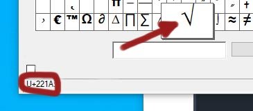

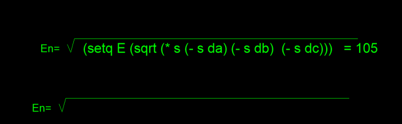

Guest Posted July 5, 2019 Posted July 5, 2019 nice job rlx. Is possible to export the results with mtext. The sqrt symbol in mtext is (U+221A) Quote
