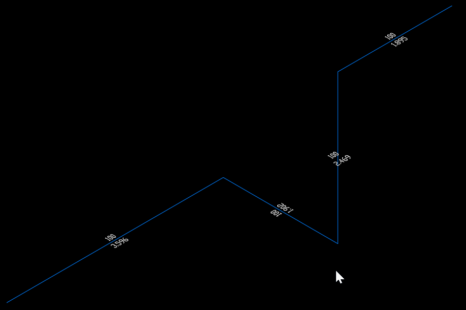

I have two texts associated to a line. Because the texts represent some data of the line they are always considered children of the line and visible next to it. Through some lisp routines, if the data of the line change, the text entities reflect the change by changing their text. For that I have stored the handle of the line to each text as xdata and vice versa, e.g. the handles of the texts into the line.
The problem arises when I copy the  line with the texts where each one gets a new handle but the stored xdata are giving the old handles which leads to further problems. I thought the vlr-copied reactor could solve my problem but since I am not very proficient with reactors I cant seem to make it work. Could someone point me to the right direction? I found this

Here is a visualization of the problem.
Is Lee listening? Any one else is of course very welcome.

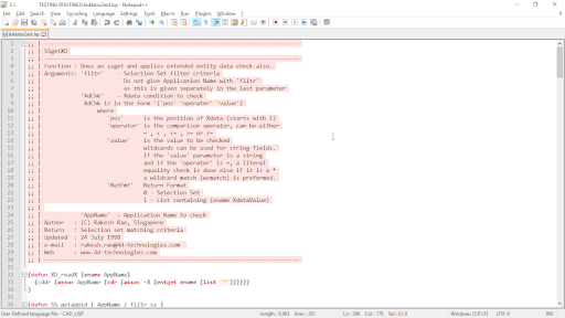

Here is my version, if it can help you somehow...
;; | SSgetXD
;; | Function : Does an ssget and applies extended entity data check also.
;; | Arguments: 'filtr'    - Selection Set filter criteria
;; |                         Do not give Application Name with 'filtr'
;; |                         as this is given separately in the last parameter
;; |            'XdChk'    - Xdata condition to check
;; |             XdChk is in the form '('pos' 'operator' 'value')
;; |                 where
;; |                    'pos'      is the position of Xdata (starts with 1)
;; |                    'operator' is the comparison operator, can be either
;; |                               = , < , <= , >= or /=
;; |                    'value'    is the value to be checked
;; |                               wildcards can be used for string fields.
;; |                               If the 'value' parameter is a string
;; |                               and if the 'operator' is =, a literal
;; |                               equality check is done else if it is a *
;; |                               a wildcard match (wcmatch) is preformed.
;; |                    'RetFmt'   Return Format
;; |                               0 - Selection Set
;; |                               1 - List containing (ename XdataValue)
;; |            'AppName'  - Application Name to check
;; | Author   : (C) Rakesh Rao, Singapore
;; | Return   : Selection set matching criteria
;; | Updated  : 24 July 1998
;; | e-mail   : rakesh.rao@4d-technologies.com
;; | Web      : www.4d-technologies.com
