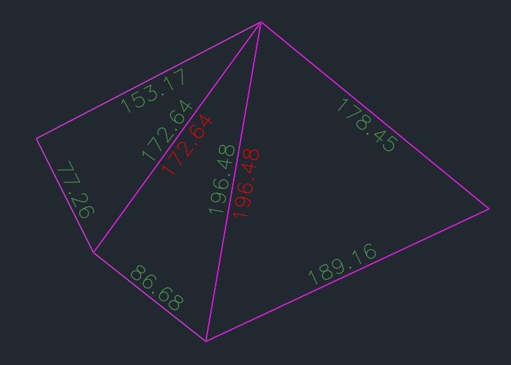

Hi I am using this lisp code to add dimensions to polygons .I need to update the code, to select multyple polygons without  add duplicate dimension.

When you say dimension do you mean annotate each polyline segment with its length (no duplicates) or do you actually need a dimension?
Your lisp has a line getting an area. Do you need an area for each polyline and/or a total area? If so, is the hatched area also surrounded by a polyline?
The lisp is also drawing circles at each vertex, but the image doesn't show any. Do you require this?
Are any "open" polylines still deleted or do you only want to select closed polylines?
What about "open" polylines where the polyline has been drawn with the start point and end point the same (not closed but drawn closed)?
Hi dlanorh. ;
I mean annotate each polyline (open and close polylines)  segment with its length (no duplicates) . I don't want the area
Thanks
Try this. Let me know if you want any tweaks. It currently creates a layer, "_dimensions", asks for a selection set of lwpolylines and annotates each line (no duplicates), putting the text on layer "_dimensions". Text ht is 1.75 (can be user input if required). Text style is current text style.

Hi dlanorh
I update the code to support annotate dimensions but i have problem with the text size. I want in paper space the text size 1.75 . I want to ask you somethig. if i select one polygon (open or close) and add  dimensions  and then i add another polygon  and add dimension Is any way not to add duplicate dimesions ?
An something else. The perimetric dimension all the time must be inside the polygon

1 hour ago, prodromosm said:
Hi dlanorh
1. The lisp is currently set up so that you can select all the polygons at once into a selection set, as opposed to a loop to select one at a time.
2. Will look into text sizes
3. Will look at perimeter dimensions, shouldn't be difficult (kiss of death)
OK try Mk2 attached.
Things to note.
1. If you want the correct paper space height the lisp needs to be run in paper space through the required viewport. The viewport scale must have been set otherwise the text height will not  be correct. If you change the scale of the viewport you will need to erase the text and re-run the lisp.
2. I don't have the stipulated text style font so I have changed it to romans.shx so I could test. You will need to change it back to your required font. Please note the comment at the end of the line as it will prevent error if you change the font to a *.ttf.
3. Perimeter text problem solved, but not as neatly as I would have like.

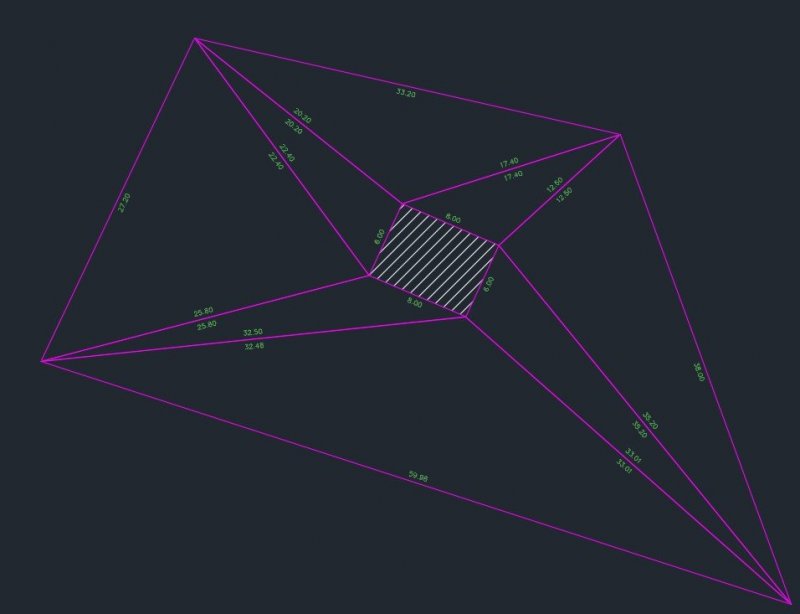

when i run the lisp in paper space through the required viewport i have duplicate dimensions !!! I want to run the code through model space
Wgsimpl.shx
Edited by prodromosm
I don't get duplicate dimensions unless I run the lisp multiple times, each time selecting a different polyline. You're supposed to select ALL the polylines at the same time to form a selection set as you asked in your first post. It won't work if you don't use it properly.
If you want to run it in model space then run it in model space, but the text won't be the correct height in paper space through a scaled viewport as model space scale is 1:1.
I select all boundaries one time and i have duplicate dimensions
Ok . Let me ask something else. Is any way to  read  all the text of the  "_diast" text style and delete find the same texts and keep one of them or give you an option what text to delete?
Thanks
Maybe you can get better help, if you upload your sample.dwg , and all the task to do.
I will try to make a LISP to clean duplicate text at both side of each segment.
This is a great help. For some reason the check for the mid point of each segment works on my test drawing but fails in yours. I've check the system vars I think could be affecting it but cannot find anything. I may have to try changing and resetting the units, or find another way of checking for a duplicate segment.
OK. I knew I had a snippet around that did this. Try the attached. This works on your drawing on my system, but takes a little longer.
qqannot2.lsp
Amended attached.
They lisp cannot know whether text is inside or outside an open polyline, because by its nature it is open. The attached now puts the distance text onto open polyline segments, but you'll have to move it if it is incorrect.
I'm too tired to think so I'm off to bed.
qqannot2.lsp
