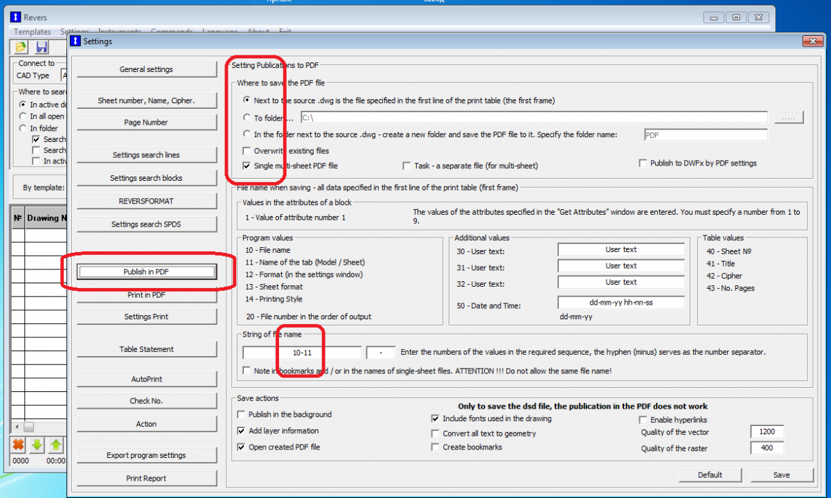

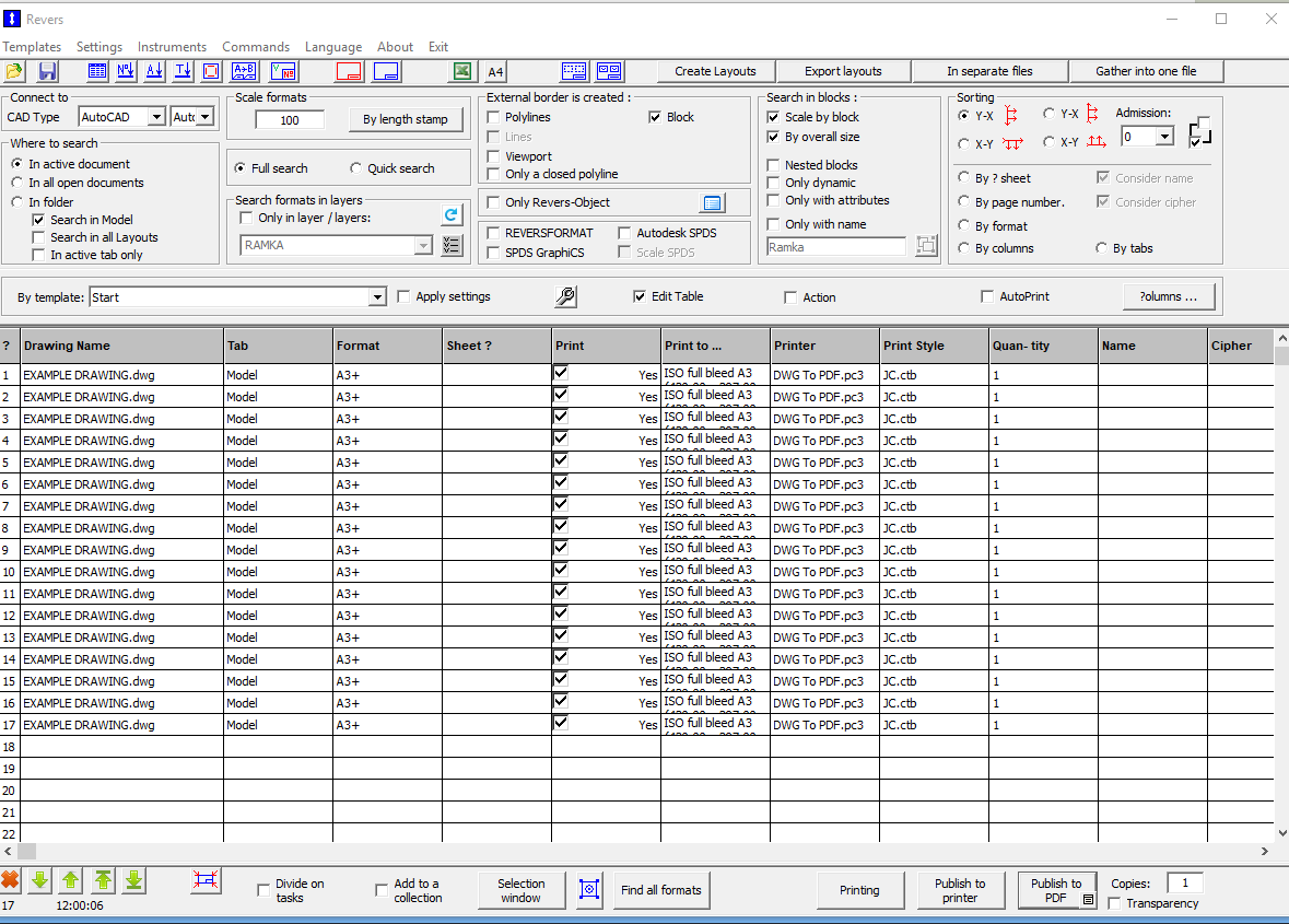

masterfal Posted June 28, 2019 Author Share Posted June 28, 2019 15 hours ago, maratovich said: Trial version = full version. All functions work. i tried it out at home, following the way you did it in vid and got it to work no problems. now at work trying same process and its not working.. everything seems to be correct and it even says 'the publication is completed' after i click publish to pdf but no pdf file is being created not sure what i'm doing wrong. (had to grab the license as my 7 day trial expired ages ago..) Quote Link to comment Share on other sites More sharing options...
maratovich Posted June 28, 2019 Share Posted June 28, 2019 Check where to save the PDF file: Quote Link to comment Share on other sites More sharing options...

masterfal Posted July 19, 2019 Author Share Posted July 19, 2019 Hi All, Turns out in order to fix these strange things occurring, I needed to 'reset settings to default'. Don't know what it was exactly but it seems over time i'd somehow mucked up a setting somewhere which was stuffing everything up. Resetting my settings fixed it. Before i got to that point though i tested out this 'revers' program to assist with publishing. Once you know how to use it its such a handy little program. If you do alot of printing/publishing and want to try streamline everything I'd highly recommend checking it out if you haven't done so already. Quote Link to comment Share on other sites More sharing options...
