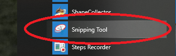

eldon Posted June 25, 2019 Posted June 25, 2019 I use the Snipping Tool when in Google Earth and save as a PNG, which inserts into AutoCAD without problems. Quote

lrm Posted June 25, 2019 Posted June 25, 2019 (edited) As @eldon recommended, use the Snipping Tool. If you are using Windows 10 you can find it under Windows Accessories. It is more efficient than Print Screen and gives you the option of saving the file in a variety of formats. Drag the icon to your desktop for easy access. If you want to insert the image into AutoCAD you do not need to save the image. Just click the copy icon in the Snipping Tool window and then do a Ctrl-V (paste) in AutoCAD. Edited June 25, 2019 by lrm Quote

SLW210 Posted June 25, 2019 Posted June 25, 2019 5 hours ago, David Devitt said: To SLW210: That's been the misunderstanding that I'm having with Adobe DC. I've followed the the steps (In Acrobat, choose File > Create > PDF from Clipboard. Or Choose Tools > Create PDF > Clipboard > Create) but how do I copy content to the clipboard? My "Print Screen" key doesn't seem to work in that way. That seems to be a problem on your computer and Print Screen, I have no problems here. What OS are you using? What are your computer specifications? I usually work on such things in a photo editor to crop and clean them up, so I select and Copy to Clip Board from a photo editor. The Snipping Tool should do the trick. Quote
David Devitt Posted June 25, 2019 Author Posted June 25, 2019 Thank you Everyone for your help and suggestions. The Snipping Tool seems to be the answer! Quote
