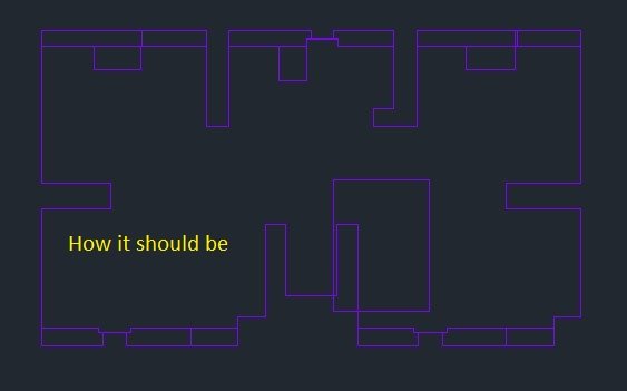

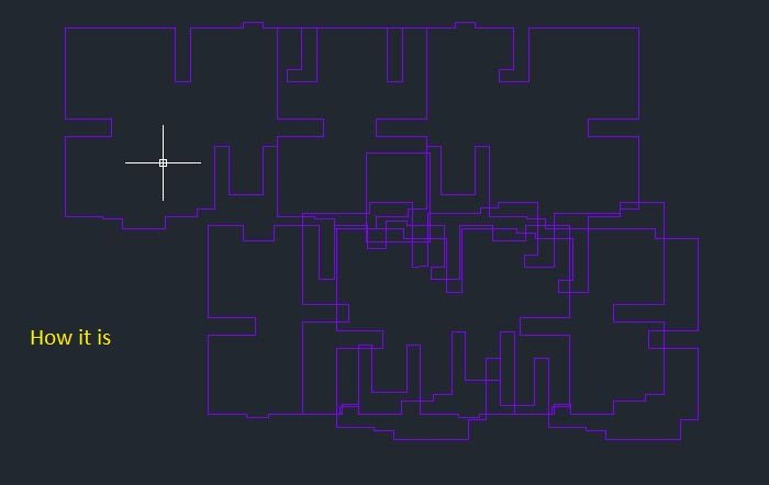

I have  attached the picture how the program should be running and how it is running now. I hope you could understand the issue with this code.

Your code has several issues. But the cause of the problem lies in this part (reformatted);
(cond
  ((= layrname "_Floor")
    (cond
      ((= tst "INSERT")
        (setq blockname (cdr (assoc 2 (entget (ssname sset ctr)))))
(cond
  ((= "Direction Ref Point" blockname) ; This returns T for items after the "Direction Ref Point" block.
    (setq bpt (cdr (assoc 10 (entget (ssname sset ctr)))))
The bpt variable gets updated with point data from items processed after the block.
Consider this instead (note the use of 'and'):
(if
  (and
    (= "_Floor" layrname)
    (= "INSERT" tst)
    (= "Direction Ref Point" (cdr (assoc 2 (entget (ssname sset ctr)))))
