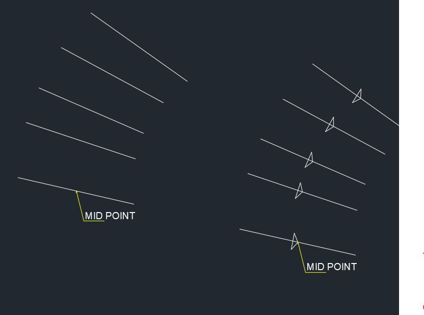

REQUIRE LISP FOR DRAW BLOCK AT MID POINT OF PLINE WITH SAME ROTATION AS PLINE.
SEE IMAGE
THANKS
Attached is block to insert. The drawing is not a block but contains a block. Insert the drawing as a block and explode and you will be left with the block.
The lisp below will handle LINE's and LWPOLYLINE's

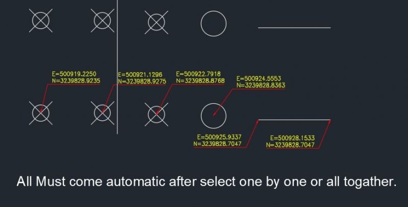

i need another lisp also,
see image.
require leader with easting , northing of points object , circle center, polyline end and start.
Try the attached. It inserts the leader/text as a mleader in the current mleader style. This must be set up correctly for your desired text size, since I don't know what this is.

THNAKS  A LOT,
WORKING NICELY,
JUST PLZ ADD A SMALL CODE FOR LAYER,
ALL LEADER AND TEST MUST COME IN LAYER AUTOMATICALLY.
LAYER NAME: LABEL

Good morning. I tried your bm.lsp which inserts a block aligned to line or pline but I get Oops an Error : Automation error. File error occured. I have placed my drawing in my search path lisp directory and edited lisp with my blocks name but it didn't work. If you get time, can you tell me what I'm doing wrong.
Thank you,
David
2 hours ago, notredave said:
dlanorh,
Thank you,
David
I can reproduce the error when the required block ("ARBLOCK") is not in the drawing.
Has the block attached to post 2 been loaded into the drawing? (Read first line of post 2) The block must be present in the drawing, It is not loaded by the lisp. If you want to reconfigure the look of the block or use another block; then use the block in the attached drawing as a guide to orientation.

dlanorh, that did the trick by having block in drawing before executing. Thank you very much for your time and efforts. I appreciate it.
David
