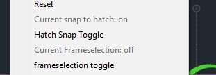

harinezumi Posted June 19, 2019 Share Posted June 19, 2019 Hi, I have some variables wich I sometimes need to toggle, so I made my menu commands. I managed to create a command to show the current value and another to actually toggle it. Is there a way to merge the two? like showing the command "turn frameselction ON" (or OFF based on current value)? Here are my commands: toggle snap to hatch command to show current value (Command Name line in the CUI) ~Current snap to hatch: $(index,$(getvar, osnaphatch),"off,on") command to toggle (Command Macro line in the CUI) 'osnaphatch $M=$(xor,$(getvar, osnaphatch),1) and similarly for "frameselection" I hate the need to have two separate lines in the menu. Thank you Quote Link to comment Share on other sites More sharing options...

steven-g Posted June 19, 2019 Share Posted June 19, 2019 (edited) Wouldn't you know it, post a negative answer then 2 minutes later you find the solution, try this in the command name section $(index,$(getvar, osnaphatch),"Current snap to hatch: off,Current snap to hatch: on") And place your other code in the macro section. PS nice idea, I'll be adding a few of these myself Edited June 19, 2019 by steven-g 1 Quote Link to comment Share on other sites More sharing options...
tombu Posted June 24, 2019 Share Posted June 24, 2019 A Display Name of $(if,$(and,1,$(getvar,ossnaphatch)),!.)OsnapHatch displays highlighted when on. Simple and easy alternative for displaying whether a system variable is On -vs- Off. For newer versions the proper macro would be ^P'setvar;osoptions;$M=$(if,$(and,1,$(getvar,osoptions)),$(-,$(getvar,osoptions),1),$(+,$(getvar,osoptions),1)) ^P with a Display Name of $(if,$(and,1,$(getvar,osoptions)),!.)OsnapHatch While OsnapHatch still works in 2019 it's hasn't been listed in help since before the 2015 versions. 1 Quote Link to comment Share on other sites More sharing options...

harinezumi Posted June 26, 2019 Author Share Posted June 26, 2019 (edited) On 6/19/2019 at 6:43 PM, steven-g said: $(index,$(getvar, osnaphatch),"Current snap to hatch: off,Current snap to hatch: on") I only prefer to changeit to "Toggle snap to hatch ON,Toggle snap to hatch OFF" wich I find more meaningfull Edited June 26, 2019 by harinezumi Quote Link to comment Share on other sites More sharing options...
