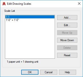

svorgodne Posted June 14, 2019 Share Posted June 14, 2019 Hello everyone, I want to purge a bunch of drawings from not desirable annotative scales linked to layouts in the paper space. (Please see attachment) I cannot purge this specific annotative scale. I have a bunch of drawings (a little more than 400) and I want to get rid of this one: 1'-0" = 1'-0" I don't want to edit it. I want to delete it completely. As I mentioned before, it is attached top the Layout itself. Please help me, it is making me crazy not to be able to solve this problem. Thanks in advance Sergio Quote Link to comment Share on other sites More sharing options...

svorgodne Posted June 17, 2019 Author Share Posted June 17, 2019 Thanks Ammbake, maybe I was not explaining myself correct. I know it is possible to change the viewports annotation scales. I know the process. My question is (please take a look on the attached picture) I want to get rid of the 1'-0" = 1'-0" as shown on the picture. I know it has to be set to a 1 = 1 (metric) But I don't want the inches annotation scale. I want the metric annotation scale. Quote Link to comment Share on other sites More sharing options...

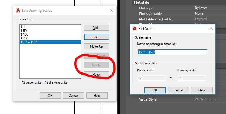

SLW210 Posted June 18, 2019 Share Posted June 18, 2019 Someone renamed the original 1:1 to the 1'-0" = 1'-0" So delete the other 1:1 and rename that one back to 1:1. Quote Link to comment Share on other sites More sharing options...
ammobake Posted June 18, 2019 Share Posted June 18, 2019 To get the scales list you want go to options, preferences, default scales list, change the selector to imperial and click ok. -ChriS Quote Link to comment Share on other sites More sharing options...
steven-g Posted June 18, 2019 Share Posted June 18, 2019 Try this link it shows an apparent solution using Lisp, I'm on LT so I can't test it on your file, but I can confirm it would drive me crazy too, you can delete and rename anything but that default scale remains 12 paper units = 12 drawing units, and you should be able to have that set as 1 paper unit = 1 drawing unit. Quote Link to comment Share on other sites More sharing options...

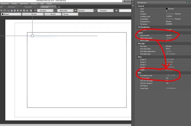

svorgodne Posted June 21, 2019 Author Share Posted June 21, 2019 Thanks everyone, I am sorry I am not able to explai myself correctly. I try to simplify the drawings I sent for them not to have extra not needed information. I'll try one more time. My problem is I have a lot of drawings which are having two annotation scales for 1 to 1 units One is 1:1 The other is (I don't need this one) 1'-0" = 1'-0" See attached file please I want to keep the drawings clean without extra information which may cause troubles in the future. I have a couple of questions: How can I delete this annoscale 1'-0" = 1'-0"? How can I identify which objects contain this annoscale? If I discover it, (physical or not physical like layouts) I assume I could remove this annoscale from the entity and at the end I could also remove the annoscale from the drawing database. I find the annotative scales very useful but very complicated to interact with . Once one is set, u cannot change it or edit it. It is not like layers contained in a block which are easy to remove after entities that contain this layer, were changed to another layer. Thanks in advance Cheers AnnoScales.dwg Quote Link to comment Share on other sites More sharing options...
CyberAngel Posted June 21, 2019 Share Posted June 21, 2019 If I understand your problem correctly, you want to consolidate two scales, which are mathematically equivalent. I've had this issue. The simplest solution is to begin by selecting all objects that have annotation. There are only a few entity types that allow it, so you may have to do this more than once, but it's a finite number. Once you've selected the annotated objects, open the "Annotative Scale" list. Delete the scale you don't want. Some of the objects may not have that scale, but it doesn't matter. The important thing is that you don't have to do this for single objects, you can do it for whole types. Open the master scale list. If you have deleted the unwanted scale for all objects, you may now delete the scale. If you can't delete it at this point, keep looking for annotative objects. Again, you don't have to find each object, just types of objects. Quote Link to comment Share on other sites More sharing options...
