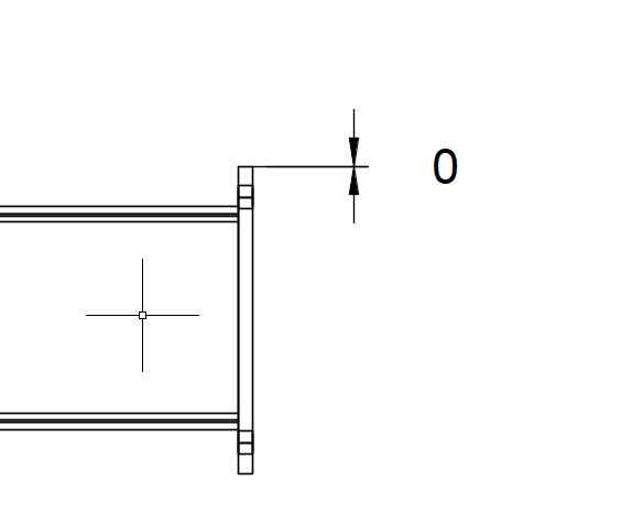

When I am dimensioning, primarily in paper space, I select the 2 end points of the item  to be dimensioned, the dimension text shows the correct dimension.
Often when I place the dimension line one of the end points will jump to some other position. Often it is to the other end point showing a dimension of zero although it frequently jumps to some random spot which does not even have any geometry associated with it.
It has even happened when I have saved and reopened a drawing resulting in incorrect dimensioning on a fabrication drawing.
Has anyone else had this happen?
Does anyone know how to fix it.

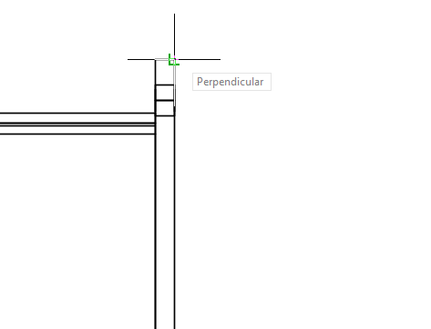

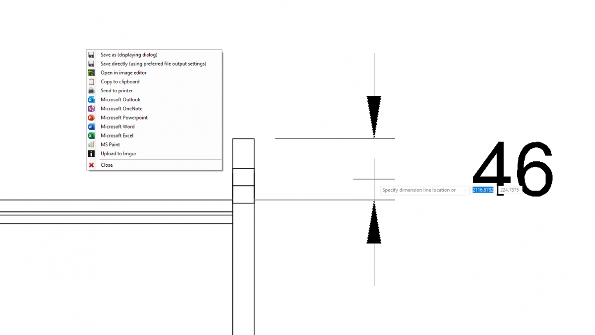

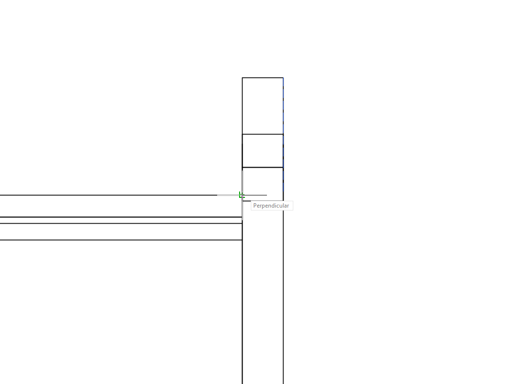

I have attached a series of screen shots of the issue.
First is choosing the first dimension point
Second is choosing the second dimension point.
Third is positioning the dimension line.
Fourth is the dimension when I select a point for the dimension line.

Looks to me you are using PERPINDICULAR Snap. You need to stick to snapping dimensions to real locations, i.e. END, MID, CENTER

Linear dimensions always draw "FLAT" in the sense that if the original snap point is 0,0,20' the next available snap point is perpendicular to that but won't give you the option for an endpoint if there isn't one at 20' in the Z dimension.  Perpendicular would show up as the only option.
So another possible solution is to add linear dimensions with a 3D perspective so you know the first snap point for the linear dimension is exactly where you intend.
There are some pretty handy LISP routines for snapping which we use here at my work.
So instead of using OSNAP and keeping it on we strictly keep it off and use shortcuts for snapping instead.
So for like endpoints is F2, intersection, is F3, etc..
That way the snap point is always the intended target point.
