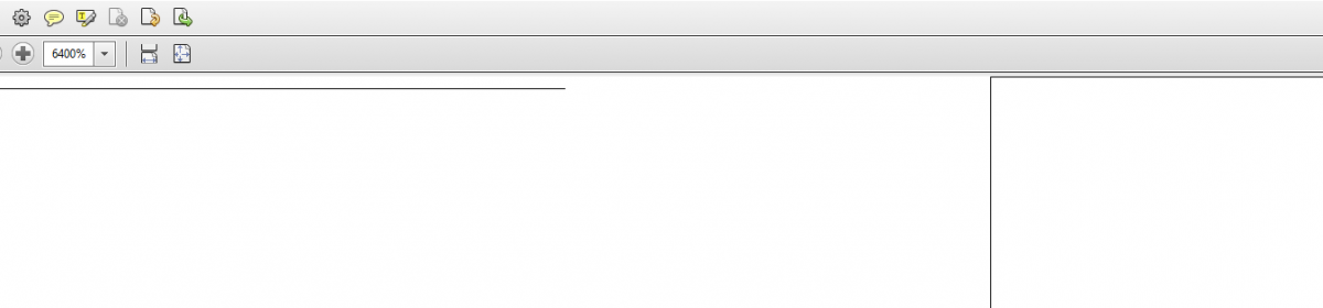

SuperCAD Posted June 6, 2019 Posted June 6, 2019 I'll apologize in advance if this has been covered, but I was shown a problem at work today and I'm completely stumped as to why it happens or how to fix it. I had drawn a structure that was exactly 119" tall and exactly 381" long. It was all done in 3D, which we all know is something that AutoCAN'T isn't good at, and I made a PDF showing the elevations to give to our graphics supervisor for production. The sheet was plotted using the stock PDF driver at a plot scale of 1:1. The dimension lines were aligned perfectly with the geometry in AutoCAN'T. After plotting, I had sent the PDF to graphics and they imported it into Adobe Illustrator and noticed something was off. The dimension lines weren't aligned to the geometry. When measuring the lines, the length between the dimension lines was exactly 119 x 381, but the geometry was measuring at 119.03 x 382.02. I had opened the PDF that I had made, turned off the line thickness, and sure enough the dimensions were not aligned like they were in AutoCAN'T. We're on 2018 with the latest version of Adobe Acrobat at work, but I wanted to try it at home. I have 2017 at home and an older version of Acrobat. I made a PDF of a simple box and the problem was the exact same. Mind you, I'm using completely different plotter drivers too. By using different drivers I was able to get closer to being exact, but each one was still a little off. And it wasn't consistent. It was off more in the Y than in the X. Any ideas what's causing this? Quote

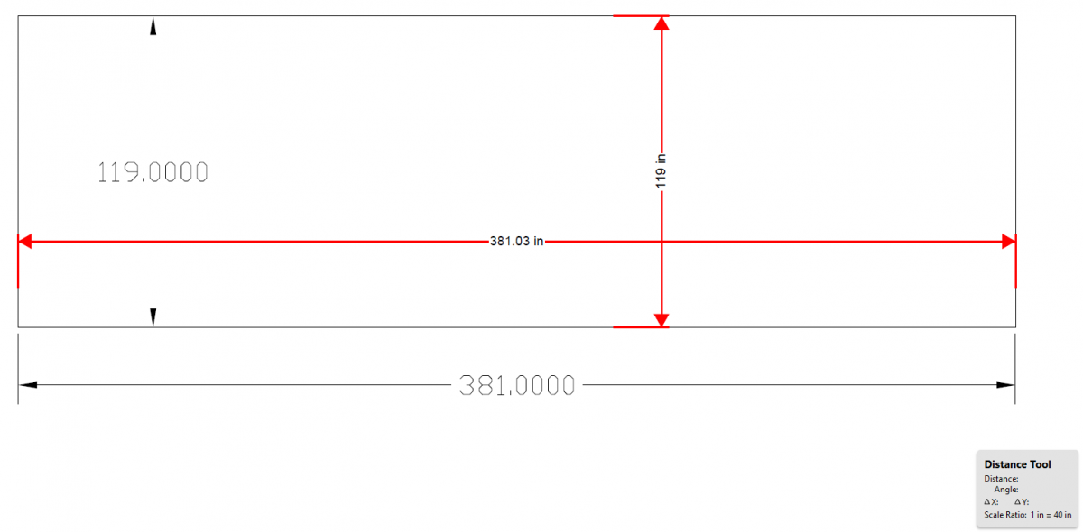

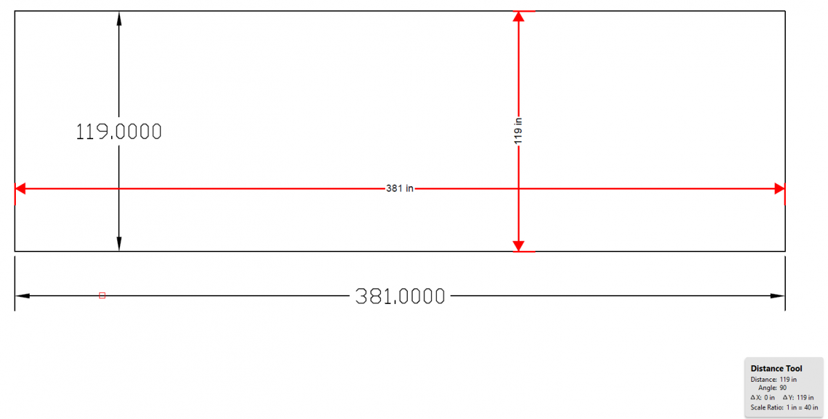

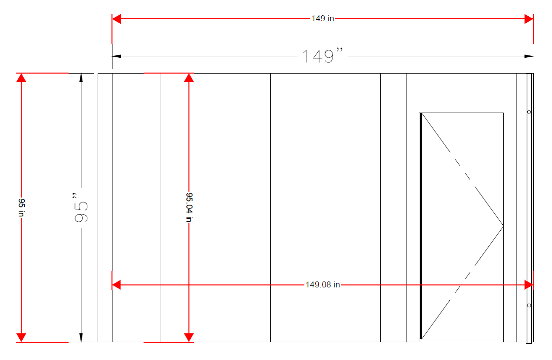

SuperCAD Posted June 6, 2019 Author Posted June 6, 2019 After more investigating, it turns out the DPI settings needed to be increased. 600 was the default, with is great for printing plans, but not for producing graphics. Tried it at 1200, 2400, 4800 and 9600 DPI and each setting gave different results. 9600 DPI being the best, but still not 100% accurate (i.e. 95 inches measured at 95.002 in Illustrator). Quote

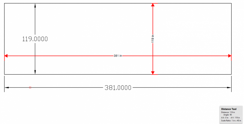

SuperCAD Posted June 10, 2019 Author Posted June 10, 2019 All of the measuring is done either in Acrobat Pro or Illustrator. I have checked every possible setting that I can access, and there are no fit to page options selected. Every PDF is created at a 1:1 scale from paper space. The issue is when our graphics department has to import the PDF into illustrator to layout their images. They have to manipulate the geometry to get to the exact size they need. This doesn't happen when sending DXF files out to our CNC machine since it's working directly off a CAD file format and it matches what we draw. Here are two examples. One using the stock AutoCAN'T PDF converter at 600dpi, and a modified PC3 file at 4800 dpi. The 119 dimension is a match in both, but the 381 dimension is 381.03 at 600dpi, but 381 at 4800dpi. Both PDFs were created from a viewport in paperspace set to a 1:40 scale. Quote

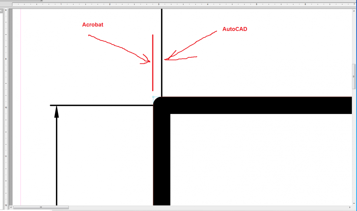

maratovich Posted June 11, 2019 Posted June 11, 2019 1. I wrote to you earlier - attach an example. Why ignore? 2. The answer is simple - in Acrobat, the measurement is made on the external side of the lines, taking into account the line thickness. In AutoCAD, the measurement in the middle of the line does not depend on the thickness. And Acrobat takes into account the thickness of the line. If you consider that you use the scale, then this leads to a 0.03 1 Quote

SuperCAD Posted June 11, 2019 Author Posted June 11, 2019 3 hours ago, maratovich said: 1. I wrote to you earlier - attach an example. Why ignore? Didn't mean to. I thought the examples I posted would have been sufficient. A DWG file was not necessary. 3 hours ago, maratovich said: 2. The answer is simple - in Acrobat, the measurement is made on the external side of the lines, taking into account the line thickness. In AutoCAD, the measurement in the middle of the line does not depend on the thickness. And Acrobat takes into account the thickness of the line. If you consider that you use the scale, then this leads to a 0.03 That's not the issue. If you turn off the lineweight in Acrobat (Ctrl+5) you'll see that the dimensions are taken from the center of the line. When I use the measuring tool in Acrobat, the line thickness is completely ignored. The thickness is also ignored in Illustrator. 7 minutes ago, rkmcswain said: ...and will never be as accurate as a vector CAD drawing. That's what I've gathered, but thank you for summing it up. That's all I needed for an answer. This is the easiest way I can think of to show what I'm talking about. The line on the left is the dimension line, and the lines on the right are the geometry that is being measured. The line thickness is turned off and you can see that they do not align. What's even more hilarious about this whole issue is what's shown below. The dimension lines measure out to be exactly what they should be, but the geometry is off. You would think that if they were only going to hold one of the two, that the geometry would be the one to make correct and have the dimensions be slightly off. Quote
