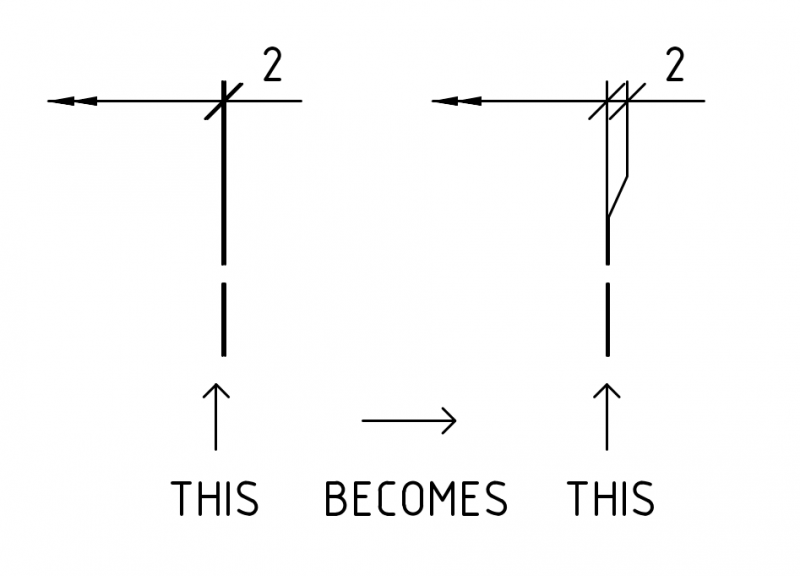

Not really sure how to describe what I am asking for... I don't really know what this type of dimension modification is called.  Here goes...
Occasionally we have the need to adjust some dimensions to better describe which direction the dimension is heading to (orientation).  Our current practice is to manually modify these dimensions to add adequate space between the extension lines to show a decent gap.

You could do with a custom lisp. Is there two lines 2 units apart which is tiny. maybe post a dwg.
Thanks BIGAL, yep 2 lines, 2mm apart in this example.  But dimension could vary depending on drawing scale.  For example, in the picture in the original post, 2mm gap is not recognisable, but at different scale.. a 10mm gap may not be noticeable, etc.

No need for dwg understand don't think its a dimension option someone else may know answer. before doing some coding.
Its common in road long sections but the code is written to handle it.
