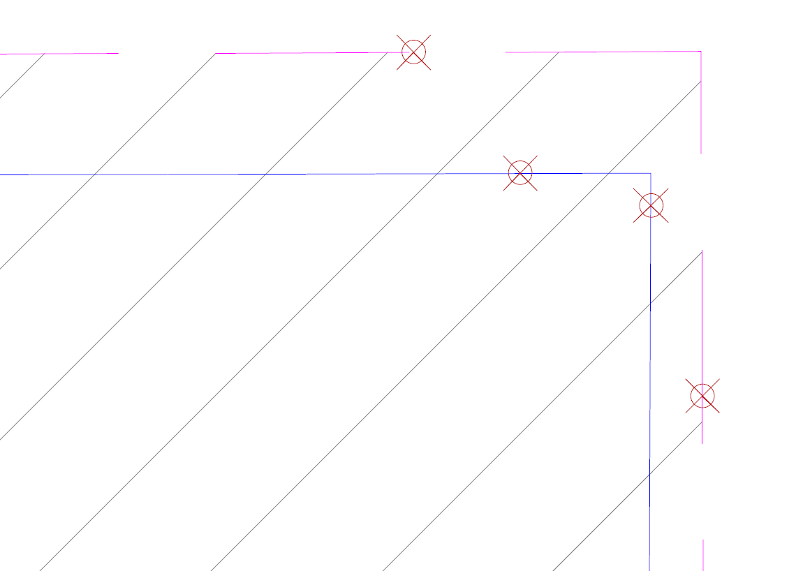

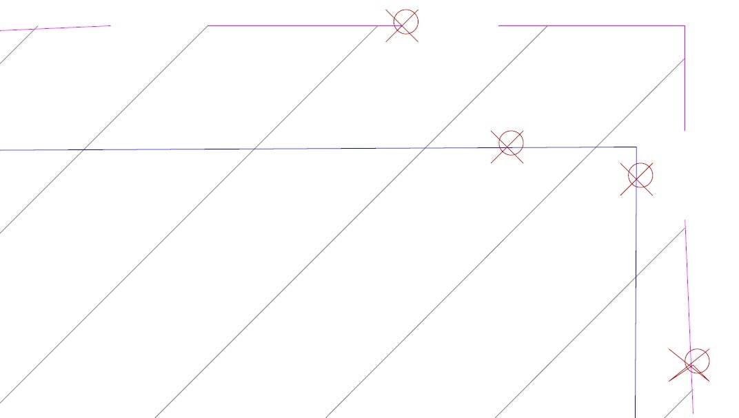

I just notice , the pdf file exported with AutoCAD 2018 is not so accurate as should be .
Pictures attached .

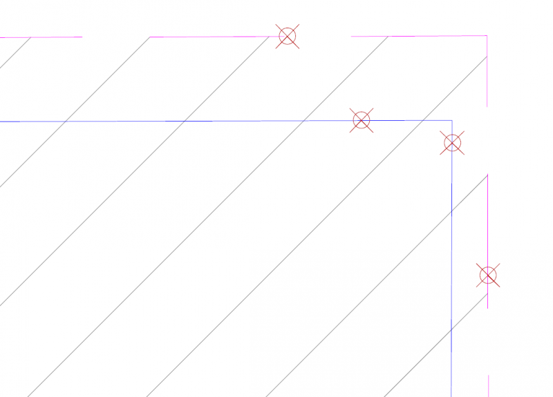

1 . Extras from AutoCAD file :
2 . Extras from pdf file :
The circles should be perfectly centered to the X polyline .
It is a way to obtain better resoults ?
Thanks in advance .

A print, whether physical or digital, is never going to be as accurate as the original vector drawing.

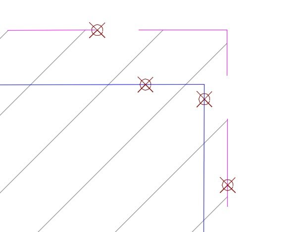

I think you are reaching the limits of how accurate a print can be. You have to zoom way into the PDF to see what your blown up screenshot shows.  It looks like it's about 0.008" off, unmeasurable on paper.  You can crank up the vector DPI settings in the driver to get it closer, the downside is a larger PDF. This image is from a PDF created with 4800 DPI set.

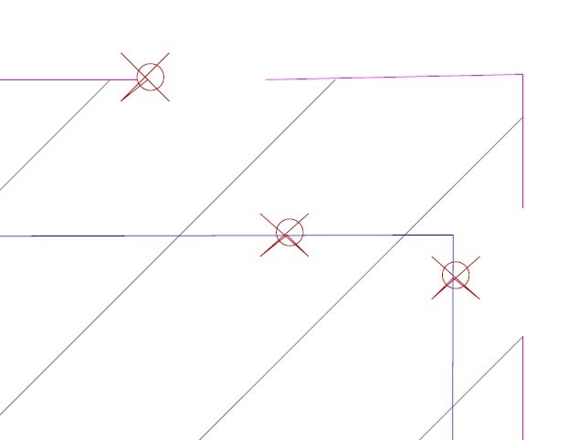

In my last attached picture , the circles and X shapes are very bad.
So , it is possible to change the DPI value in AutoCAD, before to export the PDF file?
Or to define a PDF export style?

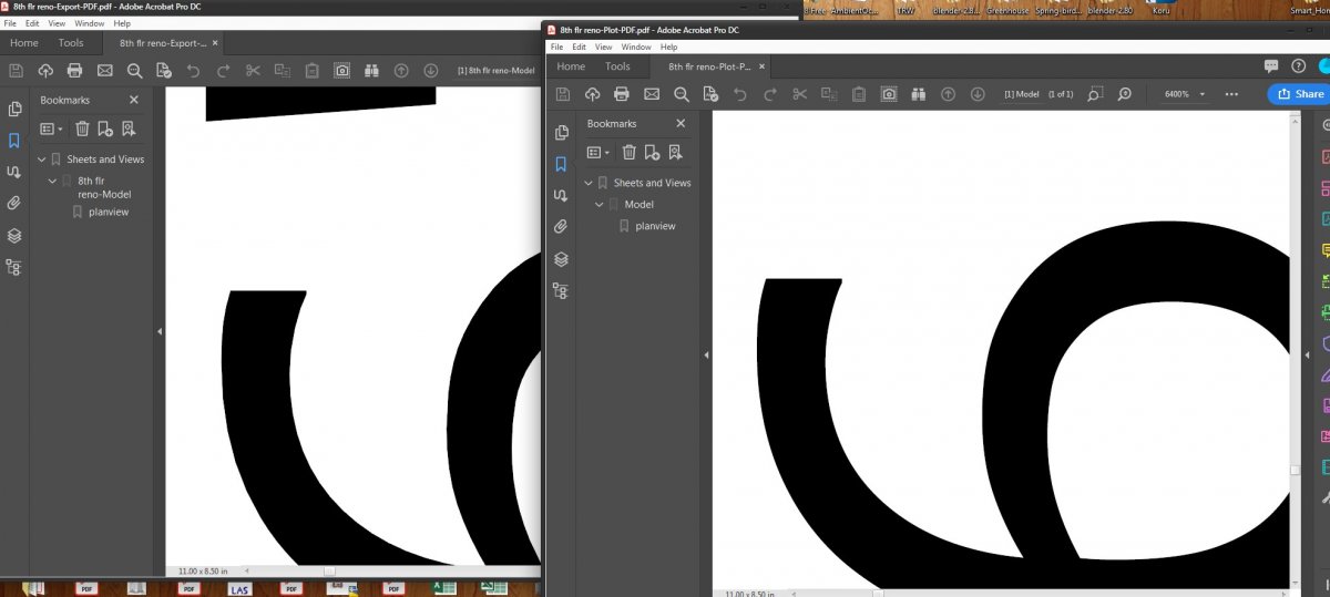

Here are 2 PDFs from the same DWG. The "Export to PDF" has clearly worse smoothness than the "Plot to PDF" using AutoCAD 2020's Plot to PDF.pc3

I am disappointed because the circles are not centered on the X or cross shapes .
