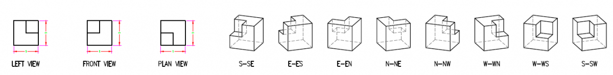

Hi,
I am a newbie here, this is my 1st post and excuse me for my English!
I use to create 2D objects/drawing from 3D solid modeling, my interest axonometric project with known scale raitio for the reason that I can change or update on the fly later.
The point here is create a view point in space via " DDVPOINT" then use "FLATSHOT" to create 2D drawing.
if you are interest in create axonometric 2D drawing from 3D solid in AutoCAD let me know!
Phong
image.thumb.png.f428111872d801a8feeb491731458a44.pngimage.png.cb9fb193a43a8de4157ea8bcee6eab3c.png
Compile lisp file for setup DDVPOINT to create view point as samples shown above
avp.fas (axonometric view point)
at command prompt type "avp"
avp.fas

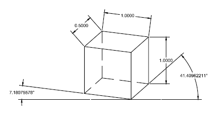

Dimetric projection with known scale ratio is actually benifit, manipulate or edit dimetric object/model is preditable since known scales.
Regarding scale axes ratio the most common are:
1, 1, 1/2
1, 1, 2/3
1, 1, 3/4
In AutoCAD to setup viewpoint for axes with scale 1, 1, 1/2, at AutoCAD command :
(vl-cmdf "_vpoint" '(1.0 -2.64575 1.0))
For axes with scale 1, 1, 2/3, at AutoCAD command :
(vl-cmdf "_vpoint" '(1.0 -1.87083 1.0))
For axes with scale 1, 1, 3/4, at AutoCAD command :
(vl-cmdf "_vpoint" '(1.0 -1.59861 1.0))
Then use "Flatshot" to produce 2D dimetric view.

Regarding previous post
The second element in "vpoint" command, here are formulas for calculate exact:
(1.0 -2.64575 1.0)
2.64572 = (sqrt 7.0)
(1.0 -1.87083 1.0)
1.87083 = (sqrt (/ 7.0 2.0))
(1.0 -1.59861 1.0)
1.59861 = (sqrt (/ 23.0 9.0))
Zoom scale factor after using flatshot to get object match drawing unit scale
Formula for compute scale ratio = sqrt (0.5 * ((x*x)+(y*y)+(z*z)))
For axes with scale factor 1,1,1/2
(sqrt (* 0.5 (+ (* 1.0 1.0) (* 1.0 1.0) (* 0.5 0.5))))
For axes with scale factor 1,1,2/3
(sqrt (* 0.5 (+ (* 1.0 1.0) (* 1.0 1.0) (* (/ 2.0 3.0 ) (/ 2.0 3.0 ))))
For axes with scale factor 1,1,3/4
(sqrt (* 0.5 (+ (* 1.0 1.0) (* 1.0 1.0) (* 0.75 0.75))))
